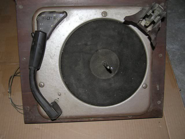

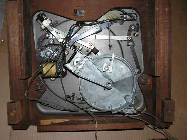

Now to the phonograph. It is a 3-speed, 33 1/3, 45 and 78. I plugged it up and got sound when I rubbed my finger on the stylus, but turntable did not move. I looked at the underside and saw numerous levers, trip switches, and gears but no belt. perhaps the motor is bad but I have not yet removed the phonograph from the radio cabinet. It also has the old style record changer with the plate and clear plastic ball on an arm arrangement that mounts on the deck.
Did the maker build their own phonograph or buy a generic one and drop it in. If I post pictures perhaps someone here can identify so I can find a manual to figure out the complicated mechanical systems involved. I haven't been able to identify serial #s or model #s.

You gotta pull the platter up there might be a c clamp on the spindle. And under that will show if it has an idler wheel or belt... CHances are they rotted and u'll need to have a rebuilt one

Here are pictures if anyone is interested.

I have the same record changer in my Hudson Phonograph, I don't know who made it but I beleive it was General Industries, this model has an Idler Wheel and two small drive belts for the 33 and 45 speeds, the first thing you need to do is lube the motor, dissassemble it, remove all the old grease, and use 3-In-1 or equivalent machine oil to lube the shaft and the bearing, then remove the platter to see if your Idler and belts are good.
Here is a picture of mine, restored they are pretty reliable.

Ok, how do I remove the turntable on this beast. I don't see how it is held captive. Does the spindle go all the way to the bottom of the unit where there is a cross retainer of some sort? I am unsure how to start disassembly to check the idler wheel or whatever it is. If someone has a schematic of a similar turntable I would be appreciative for the help. And I would get an idea of what things are called (nomenclature).

There is a "C" clip at the bottom of the spindle, it holds the Platter on, take a Flathead Screwdriver and pop it off, (Just be careful not to lose it)

Ok, got the turntable off. No old grease...bearings look ok. What is attached to the collar on the platter stem? looks like a compression fitting for wire lead. The idler wheel has the rubber around it intact. Is it supposed to be flat or round in cross-section. Also the two belts look a little worse for wear and kind of slack fitting the shafts. The big problem is all 4 of the rubber-esque grommets are crapped out...broken so they can not be reinstalled. Where are these available? Where are belts available?

You can get Belts and Motor Grommets at thevoiceofmusic.com, E-mail Gary with the Make and model of the changer, and/or pictures of the set and the parts needed, He'll fix you up good.

Ok, latest saga...spent 2 days looking for the top washer on the spindle bearing assembly. Did you know that if you turn the unit upside down with the turntable off but with the bearing assembly on the spindle while attaching the motor to deck the washers, bearings, and geared collar will all fall on the floor...I did it twice to make sure gravity still works. :oops: So I jury rigged the motor mounts because I don't yet have grommets and tested out the motor under unit power. Motor works, turntable spins, eh changer hit and miss...needs work.
The last task was to reattach the tone arm wire to the cartridge. It is a one wire with shield attached to two prongs on cartridge. While soldering I broke off one of the prongs. Can't solder to the prong base as the heat liquifies plastic to prohibit solder sticking. End of repair to turntable until I get parts such as cartridge, tone arm wire, clips, grommets, and belts. Idler wheel seems to be ok.
