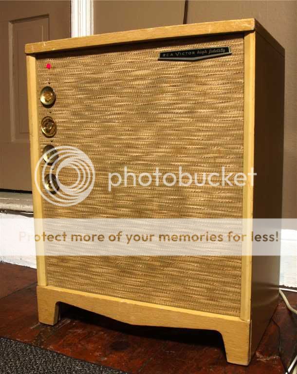

I have been working on an RCA SA-3 amplifier console. It's a model I've always wanted since I saw one of Doug's posts about one a few years ago. I've had some frustrating hum problems with it.
The guy I bought it from demonstrated it to me to show me the transformer was good before I bought it, so I knew it sounded awful and needed a full recap, which I performed. I first did the recap of paper caps, then tried it, and it sounded great except it had a hum-- ostensibly, I thought, from the electrolytics. I rebuilt the cans as usual, cutting them, gutting them, and installing new caps soldered to the original connections. I turn it on and hummmmmmmmm.
I figured I made an error in the connections so checked, rechecked, triple checked.....no luck, still had the hum. Not a terrible hum, it was mostly masked by input volume---but at zero volume very noticeable and annoying. I have recapped similar twin-6V6 phono amps and never had this issue. I checked for lead dress issues but could not see any obvious problems there. I was working on it for days, checking and rechecking, testing all caps more than once....no change. I had not sealed the restuffed electrolytics so I was able to check all connections for shorts, etc.
Then I decided to take the restuffed caps apart and just mount them under the chassis as a last resort. The hum vanished. I then proceeded to push, prod, bump, shake the amp while running to see if there was any change, but it sounded perfect. It's back together now with those caps under the chassis and the empty cans just crazy-glued back on. I'm happy, because I love the amp, but I'm still puzzled. Could there have been some conductance via some traces of electrolyte that I may have left in the cans?

Anything in the cans causing the problem is extremely unlikely. I suspect you just ran into and accidentally cured an extrememly aggravating nemisis of technicians everywhere. A ground loop problem.
Back in the 70's I ran into this in some warranty repairs for some new stereo consoles. One channel had the low level hum that would not go away. The other channel was perfect. The solution after 2 days of beating my head against the wall was to disconnect the ground of one power supply capacitor, move it 1 inch to the left and reconnect it. Hum gone. There were no defective parts, no bad connections, no cracked circuit track, it was just a ground loop problem. Three more warranty repairs for the same console came in that summer and they all got the same 5 minute correction that worked on every one of them.

I am going to say you had a placement issue. Stuffing the electros in the cans, something was touching or amiss. If one is not extremely careful of the position drilling the holes you can run into the old leads in that waxy base or ?? I think your moving the caps just happened to resolve that issue. The cans being stuffed was not the issue it had to be something else. Remember the original electrolytic can is basically 3 or 4 caps built from one unit completely exposed to each other inside and there is not issue with that. So there is no way two sealed individual electros should cause issue properly placed next to each other.
I know the tube stuff I got from you all had the electros under the chassis so maybe this was a first time stuffing cans? One has to be very very precise when doing it or these issues can happen. Did you clean the old cans extremely well before stuffing them? What did you use to glue them in? Some adhesives may be very conductive as well. Also I always strip some 22 gauge 600V wire and use the insulation over the cap leads where they go through the can base. I do NOT use shrink tubing as it is far too thin for proper insulation.
BTW I absolutely love that SA-3...that is killer....I want one of those! Anybody got one out there for sale or swap? I got some cool stuff to trade! Show us some pictures of the back of that unit with the cover off.

Thanks for the answers, guys.
No, BB, I don't always stuff cans---depends on the project-- but I've done it a lot of times in the past 20 or so years of being a hobbyist, so it's not the first time. Believe me, I checked everything on this one, and a bunch of times. The only thing that I did not do that you mentioned was use the larger gauge insulation on the wires going through the can....I just use shrink on them, however, they are going though a non-conducting material so I didn't think that'd be an issue. I hadn't glued them yet, as I was still testing, so conducting glue would not be the issue. Plus...the same hum existed before I restuffed the electrolytics anyway. I certainly would not rule out some kind of mistake on my part, just can’t figure out what it might have been. Good chance it was a placement problem, but I may never know.
The ground loop issue that Curtis mentioned sounds good, especially since the hum existed before I replaced the cans. Even if it isn’t that, it’s good to hear that from someone, since it will give me another weapon to use against mystery problems in the future. I wouldn’t mind hearing an explanation of why a ground loop occurs, if anyone can expound…
Another thing that I found fascinating about this unit is something that goes back to the previous post where I first saw one of these. I believe it was Doug who said that these were made from “leftover” record player amps from the 1955-1958 mono era New Orthophonic record players. Well, when I got this, it appeared untouched, however, there were two soldered points that looked like they’d had factory wires going to them that were just cut and removed. There was still a nub of wire left that even still had its insulation on it. I see that as kind of proof of the “recycled amp” theory.
