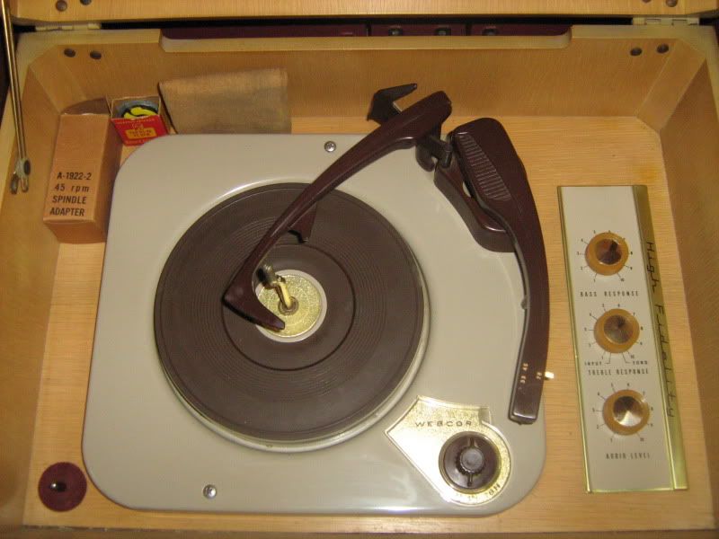

Hello. I have recently inherited a Webcor record player. I think from the 1950s. Its beautiful. Model number MT1755-1 . It still works. Even the speakers. It has the owners manual, some sort of spare clip that I think holds the needle on in the original envelope, a white spindle for playing multiple 45s, and 4 metal discs that say ’Webster Chicago corporation ’ on 1 side and ’Patent Applied For’ on other side. . I believe are adaptor discs for playing 45 records.
I was going to just put it out for trash, but I cant believe it works and is in such good condition.
Could someone help me? Was thinking of selling it. Would love for it to go to someone who would enjoy it. Any help about its history, what it may be worth, and where its a good place to sell that I won't get ripped off and where there may be vintage record player enthusiasts.
I keep trying to upload pictures but it says file too large. I could E-mail pics of it would help.
Thank you.

As for the MANY 1st-posters pop on here with the same "I just inherited" - "I just aquired" - I recently found" - etc. etc.
My reply is: in as-is condition it's worth around $20 bucks - the going rate for such articles.
It is not a gold mine, nor rare.
Properly restored by a knowledgeable tech, it'll sound great and be safe to use, as well as last a long time.
But if you want to sell it, fine, just don't expect a lot.

That's a nice record player! Hopefully, it will find itself with a collector who will properly restore it and enjoy using it!
I agree that $20-$25 would be about right in it's current unrestored condition.

If I was buying, which I am not, I would pay $55-$60 for the musicale shipped, especially if it had the GE VR-II cartridge and some replacement styluses. I sold one of those restored for $150. It sounded pretty good. On CL with customer pickup, 40 bucks .But you never know. You might get $100 if it still sounds good unrestored. If you sell it unrestored, don't sell it to a lawyer as it could burn down his house without the e caps replaced.

Your MT1755-1 is a great find. The "M" prefix on the model number, by the way, signifies the mahogany finish. I also have an MT1755-1 Musicale Coronet that was my first record player purchase when I was 11 or 12...and also a copy of it's blonde sister, the BT1755-1A. These are great sounding players with attractive mid-century styling. Made in 1957-58, they were factory equipped with ceramic cartridges and reasonably powerful push-pull tube amps.
A common issue with an un-restored Webcor player of this era is a rock hard, and therefore very noisy idler (or drive) wheel. These can be rebuilt, or perhaps an NOS replacement can be located on eBay or wherever. Also, since your player is nearing 55 years old, it could probably use a complete replacement of all capacitors (used in the amplifier).
It would be terribly difficult to assess a value based on the one picture and limited information you posted. Many times, these players will limp along and "play" as found- although not well - even though they need a needle, an idler wheel, cleaning and re-lubrication of the changer mechanism, etc. Usually, what kills the value for me is the condition of the cabinet. A water-ringed, chipped, peeling, cracked and abused cabinet and finish is more work - and more money, if you are not a DIY'er - to "fix" then it does to fix the electrical and mechanical issues. In good, original cosmetic condition, playing but needing the usual work that comes with age and the passing of time, I'd say that your player might be worth $50-75.
Here's a picture of my blonde BT1755-1A, taken when I bought it off a Craigslist seller in 2010:
