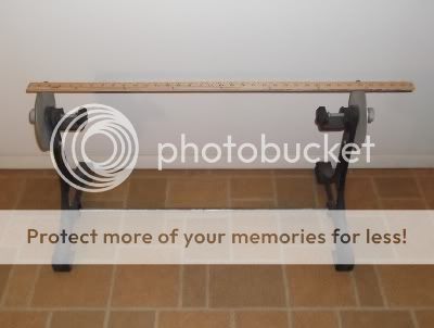

Here's what I have to do the job. It's a JFD adjustable chassis frame, and it's a real professional piece of gear.
Frame is shown at its max extension of about 24 inches. The rod at the bottom is actually two separate
rods that screw together, each about 16in long.

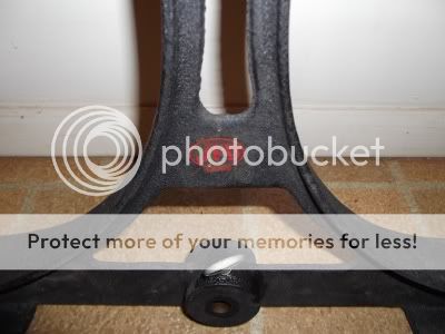

An iron (or steel?) casting (or forging?). The thumbscrew clamps onto the width adjustment rod. The brackets
have a pretty wide stance at the base, and are quite stable. It's also easy to clamp it down with bolts or lags
and some fender washers, if needed. Painted in the usual black crackle finish typical of the 40's and 50's.

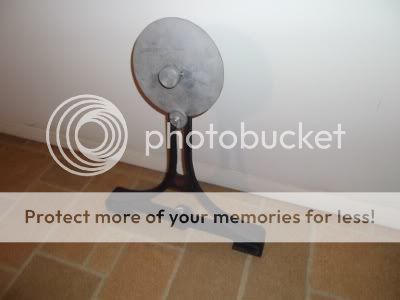

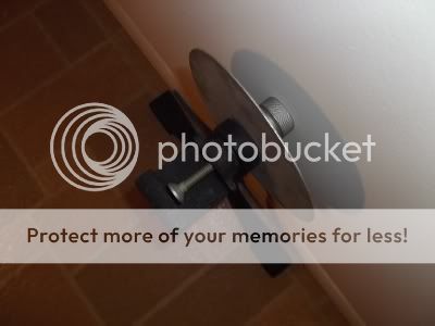

The large disc is firmly clamped between two fender washers by tightening down the thumbscrew. The chassis
can be set at any working angle- upright, inverted, or anywhere in between. Nice knurled knobs ~1.5in dia.
The actual clamps are "U" shaped castings. The silver end clamps down on the outside of the chassis.
