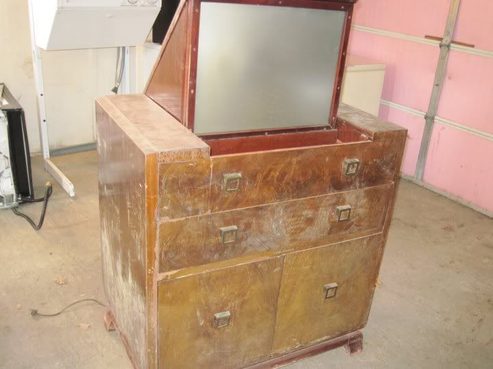

Here it is, the cabinet is really beaten up but the tubes light and there is a lit image swirl on the corner of the screen when turned on.
So there is something alive in the kine-scope. He also said there is a scratchy sound when adjusting the volume, that sounds like some part of the audio amp is working?

I finally drove out west on a business trip and picked up the TV. Here are some quick and dirty pictures. The Lacquer finish has had it and will require a strip down. The veneer is in good shape underneath and should restore nicely. The TV does work showing a twisted up display, so I know I have high Voltage. There was static on the volume control that was changing loudness as you turned it up, amp is working. I then turned it off quickly and was thankful for no arcs and sparks. The set is totally complete and once it's refinished and the chassis' is restored itshould be a great set!!

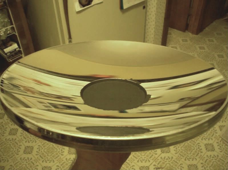

This is one-cool-set! I carefully rinsed off the corrector lens that sits on top of the projection bell with a flowing water stream, it cleaned up nicely. The spherical main mirror and the flat mirror up at the top are hazed but still work well. My I-phone projected very nicely onto the view screen. It was a bit dim, not allot of light output from the I-phone. Very neat to see the image up on the screen, too dim to photograph, sorry.
The chassis' are thick with dust but everything is there and whole! There are many inter-connecting harnesses between the 4 chassis' this is going to be a monster to work on! :roll: I'm going to have to document every move, many connections to remember. This set is a technological terror :shock: The HV cable looks down right scary, it's very heavy duty. I am definitely getting a pair of thick rubber gloves for this set, 28,000 volts will knock you on your ass if your not careful! :cry:

The spherical mirror cleaned up nicely! My other hobby is Astronomy so I am pretty good at cleaning first service mirrors without scratching them up. Looks real nice, that should brighten the picture up.
