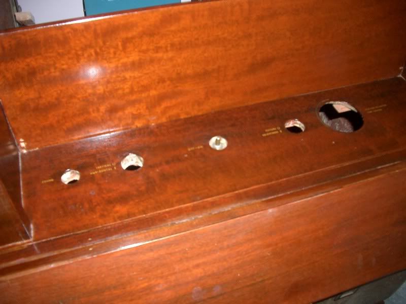

PostPosted: Mar Sun 27, 2011 11:15 pm
Posts: 1127
Location: Massachusetts
Made good progress today on both the electronics clean up and started stripping the cabinet.
Chassis' have been cleaned
Started stripping the cabinet, it's a start...
Before
After
I hit it with a test coat of Min-wax stain to get an idea of what it's going to look like.
The inner control areas are in great shape and will not need restoring.

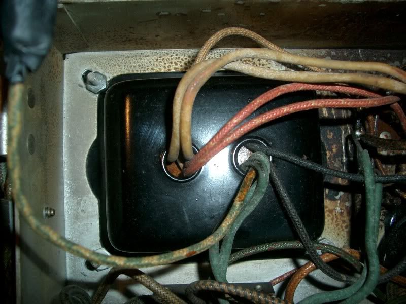

It's dangerous only if it falls on you. You might get with Chuck A about swapping out the lower power supply. One of those transformers looks fried. You can use the windings out of the old one for a radio antenna across the neighbor's back yard. Have fun....Chuck has repaired several of these....so have I. My 741PCS is a daily driver. Be careful with the video chassis in that the electrolytics' mounts are fragile and easily cracked while re-capping the underside. CRAIG
PostPosted: Mar Tue 29, 2011 1:31 am
Posts: 1127
I'm not sure what you are seeing with the transformer, there are no signs of damage to any of them. The top of then were a bit rust pitted. There is no sign of heat damage at all with either?
Steve
PostPosted: Mar Wed 30, 2011 1:43 am
Posts: 1127
Transformer mystery solved. The other night when analog.tv noted that the transformer looked bad I inspected both transformers and couldn't see any issue with the transformers but the chassis was covered in ejection spray. I plugged in the chassis and verified both transformers had good working voltages but I was still bothered by all the mess on the chassis like something had let go? Then I spotted it, T2 has been replaced with a Thordarson replacement. In the picture below you can see they had to re-drill new holes to make the new unit fit. Mystery solved! Sorry I doubted you analog.tv

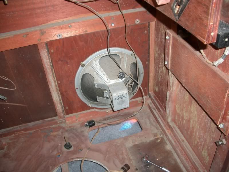

After you completely remove everything out of the cabinet, vacuum it out, and wipe the inside with Mineral Spirits, using an old cotton shirt. Not Lacquer Thinner, but Mineral Spirits. It will remove all mold, surface grime, etc. Then wipe on a thin film of MinWax Red Mahogany Stain. That will cover any scratches, etc, and really make the inside pop. Watch out for labels, etc... 8)
That's assuming it's mahogany. It looks like it.
Lee
Worcester, Mass
PostPosted: Mar Wed 30, 2011 11:26 pm
Posts: 1127
I'm reaching the halfway point with the stripping and refinishing. The grain in this wood is out of the world!!
