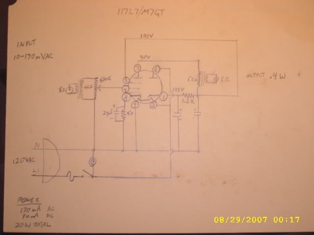

Here's one I found in an old magazine. It's only one tube but another tube could be added for more gain. I originally built it for a regen amp and something to do on a Sunday.

I have this schematic but it uses a input transformer which are hard to find and are expensive.(from my research.)

Hi
The input transformer can be another type with good turns ratio. Could even use a small output transformer in reverse.
Nicely drawn schematic but notice it's still connected directly to the AC line.

In my schematic I specify Isolated 120 VAC
