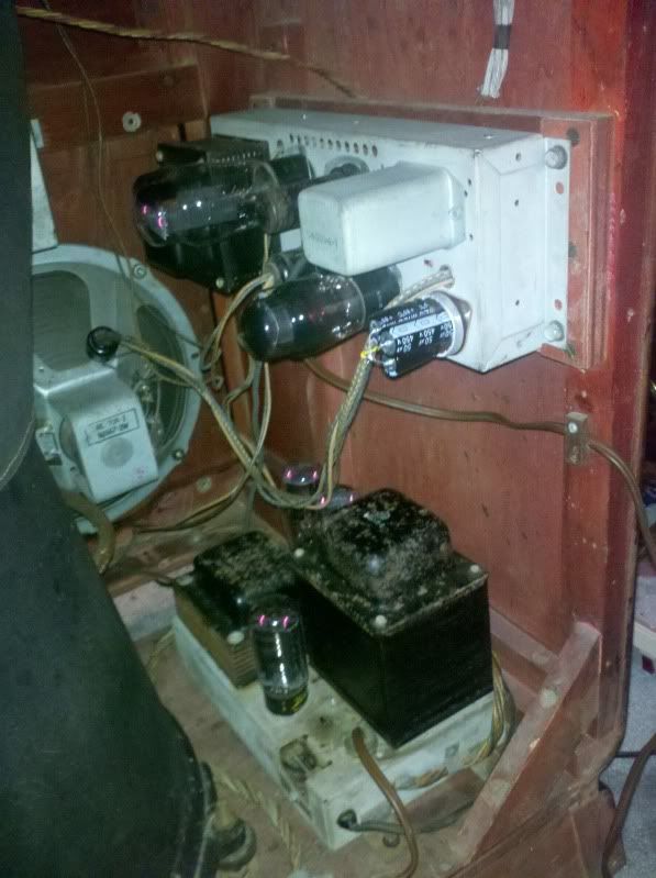

Cripes, man! This thing has more tubes, a bigger picture, and a bigger power transformer than my 21-CT-55. And it's OLDER! :shock:
pielock373 wrote:
The mains at the bottom and audio amp upper right.
It's a beast, VERY HEAVY and would make a great space heater once all the tubes get humming. :lol: The two things it needs before I call it finished is repainting the two rusty transformer tops and get the mirrors re-silvered. This TV was (and still is!) a technological terror. I'm most impressed with how much more of a picture you see compared to a round 10" TV of the same time. Having a square picture right to the edge really makes a big difference! In fact, I can't get over how much of the picture gets cut-off on my 10 RCA 730TV1 on a Side-by-Side test with the 8PCS41 set.

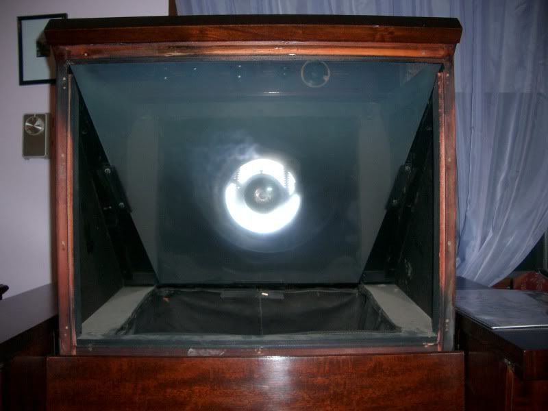

And a shot of the 45 degree right angle flat mirror that throws the image to the Fresnel viewing lens (Note how clouded with oxidization it is, down right deplorable!) I'm surprised at how well the set is working with the mirror looking like this.

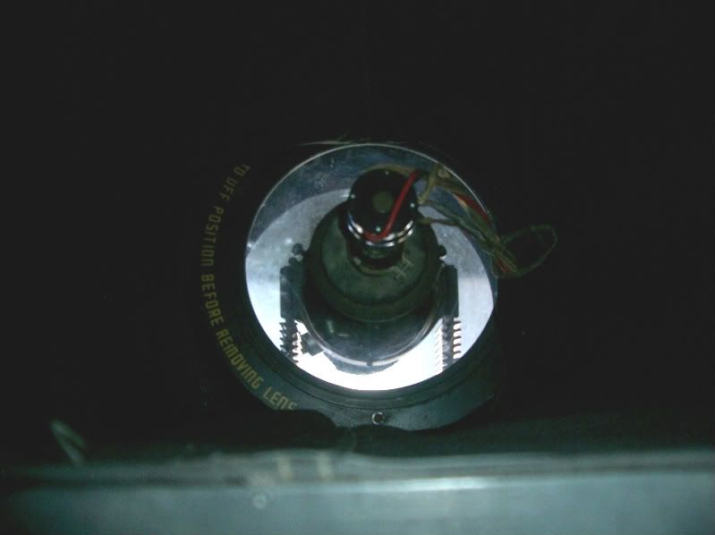

Shot from the top looking down at the picture tube optical drum. 28,000 volts be down there :twisted:

With resilvered mirrors, it might rival a modern hi-def set!

If after resilvering the mirrors the picture is not quite right (certain details blurred over, looks sort of out of focus, sharp edges blurred, artifacts around sharp edges, etc.), you should consider doing a sweep alignment of the IF strip.

If you Google "First Surface Mirror" or "Front Surface Mirror" there are a lot of suppliers of new mirrors. Can you get a front surface mirror re-silvered? Usually they do the rear surface.

Yes, there are many outfits doing front surface refinishing for telescope mirrors (My other hobby). I plan to take the mirrors to one of them for refinishing.
