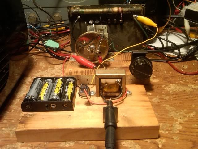

Start with something simple like this:
Cost was just scrounging a bit. No antenna or ground. The ferrite rod couples to radios a meter or so just fine. Sound is good. The parts can be reused for a tube 6LE8 or 6888 for more range. Eventually I'll stuff it in a smaller box but now it's modular so I can use the parts for other things.
Doug
