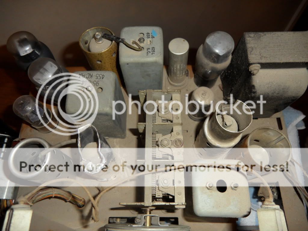

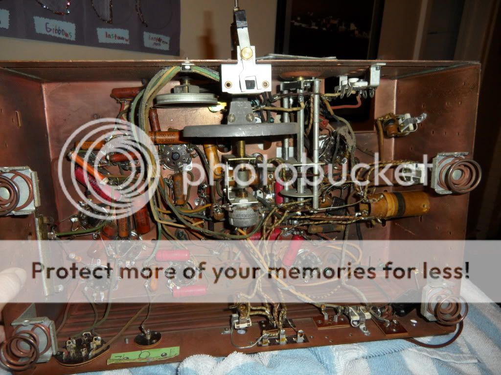

I successfully removed the chassis from a Zenith 10S690, and here it is.
Does anything look terribly wrong? On the top of the chassis, there looks to be a tube made out of foil. I am not positive, but I don't think that was standard.
Taking any and all suggestions. :)
Thanks!

Home made shield?

Yes, you do need a Zenith tube shield, although I've seen factory original cardboard shields lined with foil which work fine. That spacious chassis should make changing the paper&foil capacitors, the electrolytic capaciots, and the out-of tolerance resistors fairly easy. Are the power transformer and speaker field good?
Is that old brittle rubber wire insulation I see? If so, the spacious chassis should also make rewiring it easier.

Looks like you are missing the tuning drive belt.

1. I started cleaning it up after I posted the pictures. I will get a shield and replace the foil one.
2. Yes, that is rubber insulated wire. None of it is crumbling or brittle, but will be replacing it all.... once I figure out how to do that.
3. The tuning belt is broken, so yes, it will be replaced.
I am new to this whole thing, but am not devoid of mechanical ability. I will be picking up a radio repair book today, to begin learning how to do this. Any suggestions would be great.
What is the black box on the lower left corner of the top of the chassis? (top right of first picture. very dirty in the pic)

To make the rewiring job a little easier, you may want to just sleeve the wires. Detach one end and slide an insulating sleeve (heat shrink would work) onto the wire and re-attach. Note the path of the wire and restore it to the original, particularly in the RF section to avoid introducing oscillation. That won’t be possible on the bundled wires feeding through the chassis and they will have to be replaced since the sleeves will increase the size of the bundle. Check the candohm mounted on the side of the chassis for continuity and value. They are frequently open and need replacement. You can make a replacement, if required, by mounting power resistors on a terminal strip with the correct values.
To answer your question about the “big black box”, that is your power transformer.
When it comes time to remove the tubes, note the Loctal (7G7) has a bump on the side. Tilt the tube in the direction of the bump to remove. That will “unlock” the tube. The rest come out by pulling vertically. If they are sticky coming out, you may want to assist them by gently prying with a screwdriver (rotating the blade slowly) while pulling.

Replacing the wires, replacing the capacitors, testing the resistors, and replacing the out of tolerance resistors will all be done at once. When multiple items go to one terminal, it helps to twist one end of the new part or wire to the just disconnected end of the old part or wire.
I've found that #5 desoldering wick works best, but you can try various solder suckers and wick to see what you like.
What is that large square hole in the chassis? Is there an audio output transformer mounted to the speaker? If not, eprhaps one was mounted at that hole.

The hole in the bottom right of the picture is where the push button controls for the radio tuner fit when the chassis is in the console. It was not connected to the chassis, and there are several wires that appear to "plug" into something. I assumed they changed the tuner somehow, but have not yet determined that to be true.
