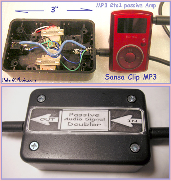

DONE
I went out for dinner tonight at about 8:30 and stopped at RadioShack to get a couple of those little transformers and a matchbox-sized project box.
Boy those transformers ARE small. Thumb nail sized. .. But only $2.95 each.
Continued on to dinner and an hour or so later got home and tested this stuff and decided to toss it all together.
Only took a few minuets.
Here it is already!
And it sounds great!
(Transformers are held in place with double sided tape.):
They provide two styles of box covers. A plastic and a metal recessed one.
I'll probably use the metal one so that my " IN & OUT " labels will be easier to read.
EDIT:
As you'll notice from the lower image I just added, that I had to use the plastic cover instead of the metal one to avoid touching one on the jack contacts because I positioned it a bit too high and vertically instead of horizontal.
As it turns out I think the plastic cover is nicer as it seems to look a little more professional.

Hi tube:
Those DO look like great transformers.
Why did you particularly chose the 15k impedance ones?
They are pretty cheap at $11 each.
However deliver is 16 bucks!! though.... lol
The RadioShack ones are only $2.95 each ...lol... and you get tiny too!
Anyway.. yes sure ... better transformer will provide a better frequency response.. sure!
But look how large they are. The ones in the article are only thumbnail-sized.
Remember this is for a tiny MP3 device too. And after all... would the MP3 signal quality and bandwidth be able to appreciate the audiophile quality?... or would the greater freq response be wasted?

While occasionally I need to combine channels for bench testing single channel amps I decided for that to use an output test-cable that ties the two channels together with 4.7uf non polar caps.
Any and all better ideas are welcome :)

processhead wrote:
I posted a schematic in my first post. It shows how L and R channels are combine in the two transformer secondaries to make a composite mono signal to feed the radio.
Did some site searches to try to find some of my earlier posts, but was only able to go back a few months. Seems like I might not be using the search terms correctly or something?
Hi Paul:
I hadn't seen your schematic because each subsequent email alert placed me further down the thread and so I failed to scroll back.
That's a very good idea for combining channels permanently.
Why are the 10 ohm resistors needed on the mp3 input? Won't the impedance of those windings alone do the job?
My unit will almost always be using both channels so I built it as I showed in my original post.
You would just use the secondaries of the transformers connected in parallel. Series connection may work, but IDK.

An audio transformer, I was thinking the same thing when I read the subject line. I'm reading that chapter now in the NRI courses that I downloaded from the Classifieds section.

The very first schematic uses an unusual transformer connection for which a nit could be
picked unless there was a reason why they were so connected. Apart from crosstalk,
the left and the right channels see slightly different resistances for most transformers.
The thing to do for an experiment is to check phase shift between between input and
output jacks across the frequency range, especially for the one with the 2 10 ohm resistors.
Its simple to do, just overlay the two traces after adjusting them to be same size, and see
if they stay in step over the generator range. Use a load resistor on the output side.

"Why are the 10 ohm resistors needed on the mp3 input? Won't the impedance of those windings alone do the job?
I read that the output impedance of an Ipod was a 32 ohms. I added the 10 ohm resisters ins series with the 8 ohm transformer winding so they would more closely match the output impedance of the Ipod.
In reality, they probably are not really needed.

processhead wrote:
About a year ago I built a circuit similar to this using these same RS transformers. The significant difference on mine was that it combined the two audio channels from the Ipod into a single channel to run directly into the auxilary input of a tube radio. I also used the secondary of the transformer winding on my project.
If you were to use this adapter with a AC/DC set and had concerns about isolation, the transformer coupling provides DC isolation to the MP3 player.
I posted that circuit here at that time with some pictures of the whole project.
The term passive amplifier is a little misleading. Although it is a passive circuit, it is more of an impedance matching network than anything else.
Since it matches the low impedance output of the Ipod to the relatively high impedance input of a tube radio audio stage, it might appear to provide gain, but what I think you are really seeing is more efficient transfer of the Ipods output power to the radio. The frequency response and fidelity was better with a transformer network than my other attempts with just a resistive network.
It does add gain. You're basically taking the transformer outputs and adding them in series for a mono signal which is larger than the input signal provided the transformers are 1:1 ratio.
