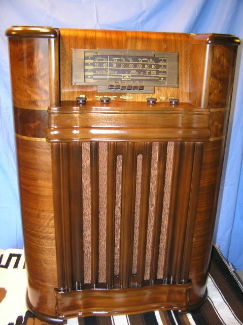

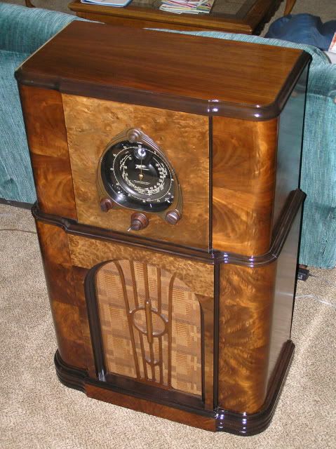

Tom, I have to respectfully disagree with you on the Harbor Freight spray equipment. I have been using the Harbor Freight touch-up gun that Gary recommended and a 10 gallon 2HP Harbor Freight compressor for three years now. I am getting excellent results with these products and would recommend them to anyone. Now, I would agree that these tools may not be up to professional grade quality, but they are certainly more than adequate for those of us who are amateurs and have the need to spray a cabinet occasionally. And best of all, the price is right!
Here are the results I am getting with the fore-mentioned equipment.

Ed, those are some amazing results, no matter what gear! I'll go with you one this one, as there is no denying that you've got it down pat with the gear you've got there. I will say this though, a pro can take almost any piece of gear and make it shine to it's capability, whereas a rookie could benefit with more easy to use, more reliable and less problematic gear, like Paasche products for instance. I obviously formed some bad memories about Harbor Freight gear, but that's just me, and we should all be able to make our own choices. Just buyer beware, I guess...
Ed, can you touch a little on your methods of using your touch-up gun and airbrush? I assume you're spraying lacquer, and if so, what products are you using? Can you explain the level of product product you lay down on each pass, what you look for in your spray pattern, if and how you layer, etc.?
