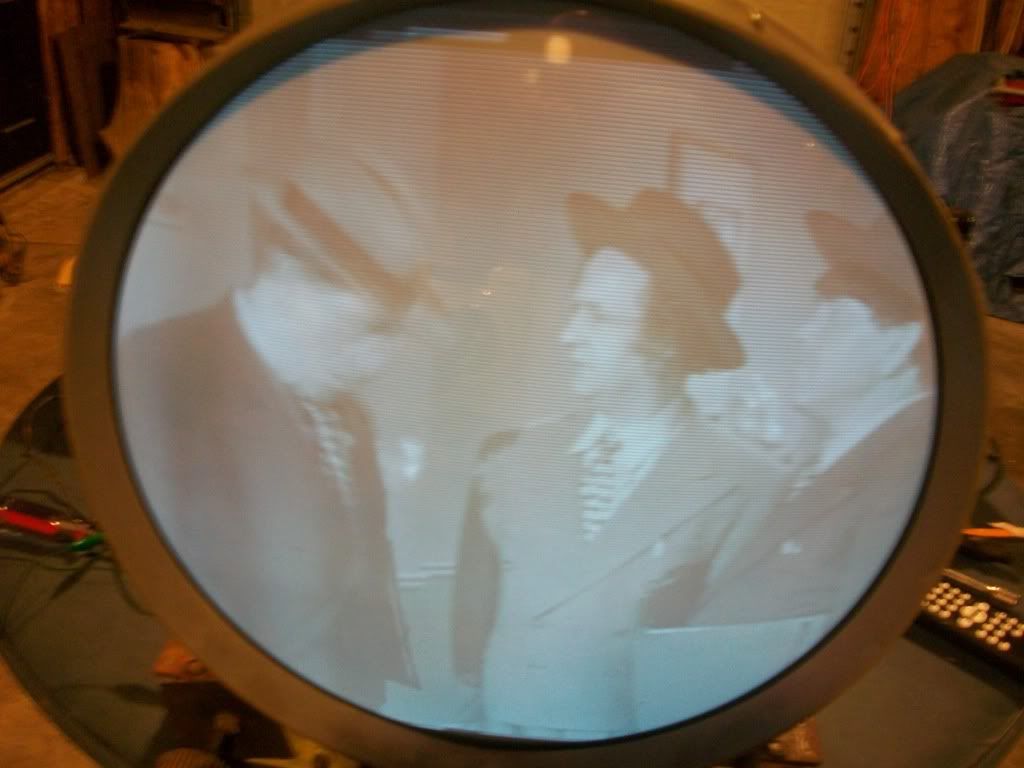

Now here is some of the problems i'm having with it so far. The picture I had to begin with was pretty good. I was trying to make a adjustment to the quadrature coil for the low sound. Well turned it off and removed the osc adjust for each channel so I could get to the quadrature coil easier. Well I turned it back on and the picture got brighter. The blacks in the picture got brighter, like a washed out picture. The brightness control works good but has no effect on the blacks getting brighter. So what do I need to do to fix this? The other problem i'm having with the picture is the horz. lines that are worse at the top of the screen than at the bottom. Is that these old tvs had? The sound on it is way to low. The quadrature coil i adjusted at its peak was still to low. And while i'm turning up the volume from the lowest point, the volume comes up and then while i'm still turning it up the volume drops off about half way on the dial and then comes back up as i'm still turning it. It's kind of hard to explain. I'll some pics soon.

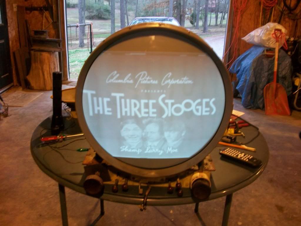

Here's a few pics of it. The cabinet is in my shed. I notice the volume is great when the set is first turned on, but after its warmed up is when the volume drops off.
You need to adjust the vertical linearity. The top half of your screen is stretched out in comparison to the lower half. The people's heads are too large and their legs are squashed and stumpy. If you don't have a test pattern generator, tune in something like a cable TV program listing, which will make it easier to tell when the top-to-bottom proportions are equal.
You may need to adjust the height at the same time, since the two adjustments are often interactive (changing one can affect the other).

Yes, I have recapped the set. I have adjusted the vertical linearity. i'm having problems with it. Its at the max. i turn it the other way and it crushes the screen down.

BTW, how does your 4:3/round slide switch work? When I switch to 4:3, the picture size is vertically too small. I never looked into this as I planned on playing it so that it fills the screen.
Here is a pic of mine with it on 4:3 ratio. You can till i'm a stooge fan.

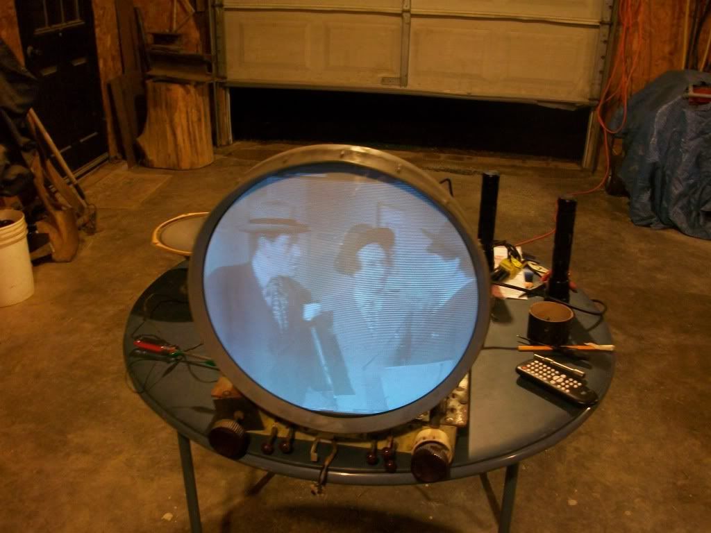

I think I had to compromise the vertical position so it would fill the screen.
Here is mine with the slide switch in 4:3 mode:
