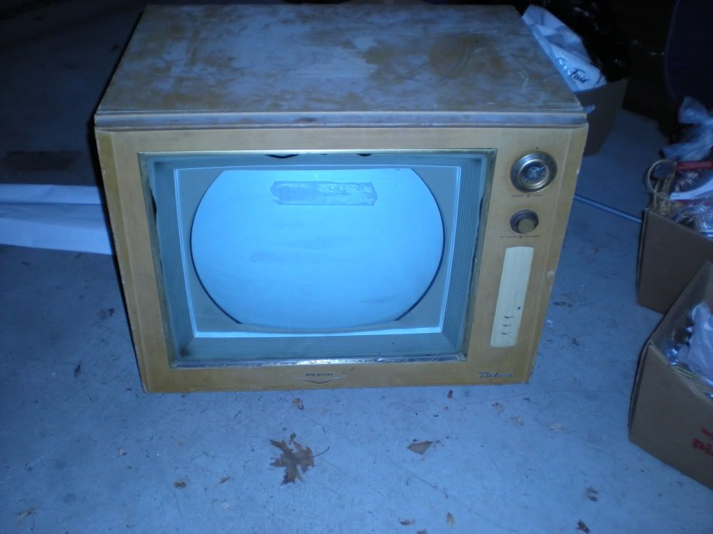

Last weekend I visited Nick to get a Zenith poster he advertised on VK, and he mentioned that he had a CTC4 he wanted to sell.
To make a long story short I ended up buying it for slightly more than 400$.
This I believe is the Seville model minus the legs. Image
Whom ever owned it before Nick did not take good care of it.
All the tubes (aside from the CRT), the speaker, the back, the legs, the channel selector knob, and possibly other stuff are all missing.

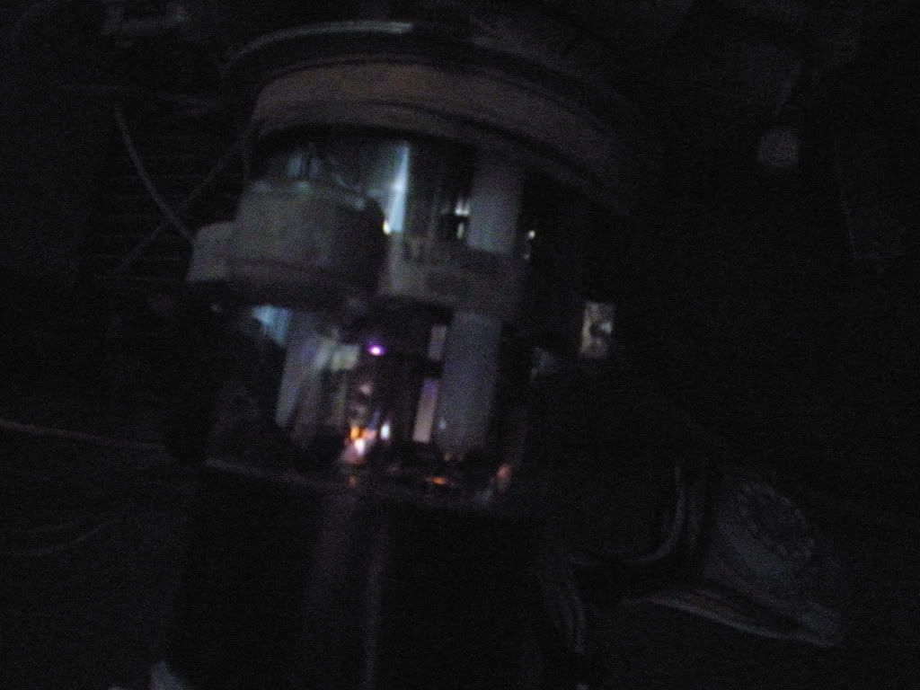

The 21AXP22 has the PNGOD (Purple Neck Glow Of Death) so it seems that I'm going to have to use a 21FJP until I come upon sufficient luck and or resources to bring a good 21AXP22 into my possession.
A nice 21FJP22 with the strongest emission of any of my roundys came with the set so I have a strong jug to put in for the time being.Image

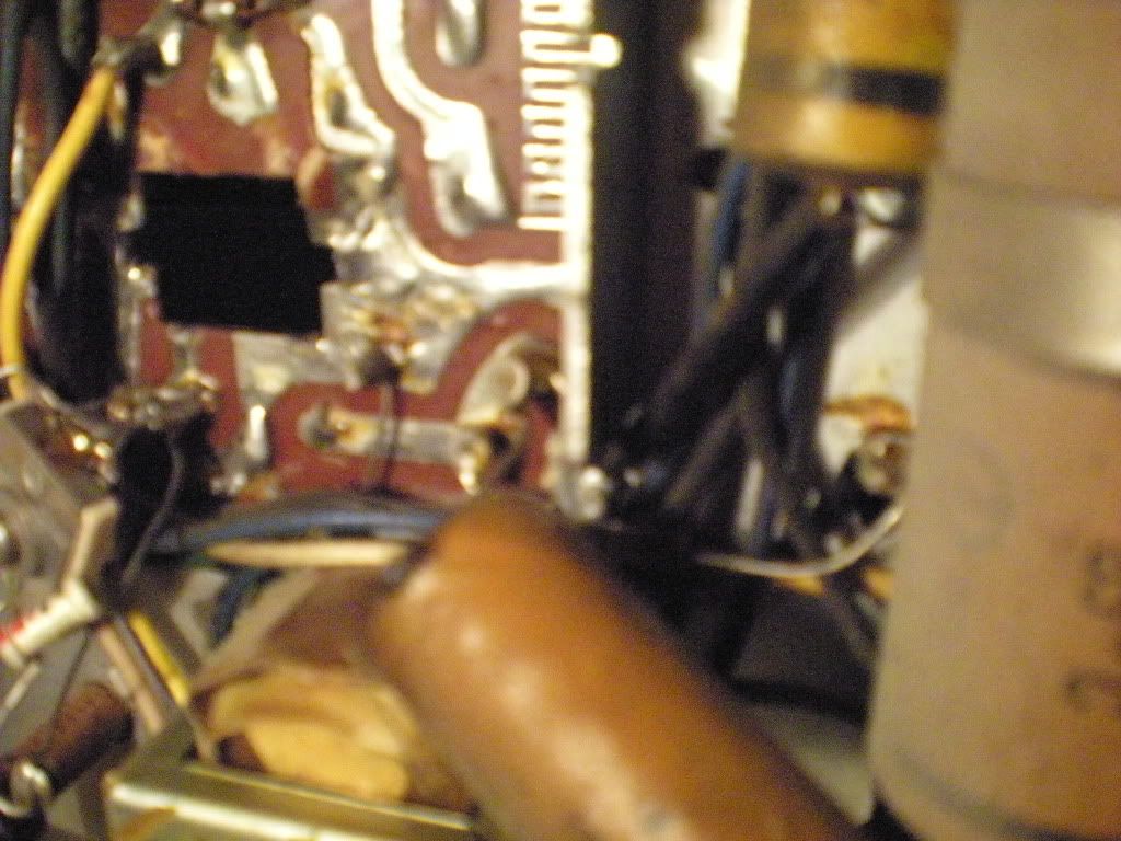

One of the IF cans got knocked off the board, but miraculously the board appears to be just fine.
I'm going to go down in a few minutes and start examining the set in day light (read pulling the chassis and examining it).
Here is a link to some pictures of it...
http://s1095.photobucket.com/albums/i469/ElectronicMemory/RCA%20CTC4%20Seville%20%20blond%20finish/
I've clearly got my work cut out for me, but still I can't suppress that "Woo Hoo! I finally have got a CTC4! :D :mrgreen: " feeling. 8)

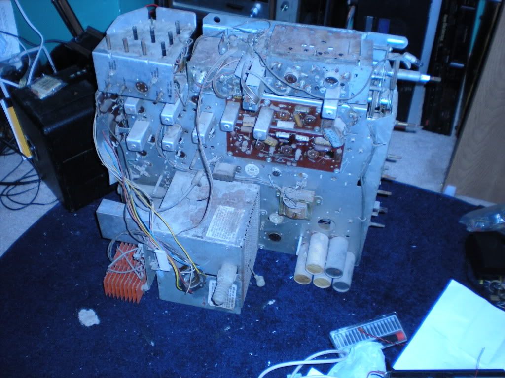

I don't even know where to begin looking for original legs, and it appears that there are factory feet for it to sit on a table. :?

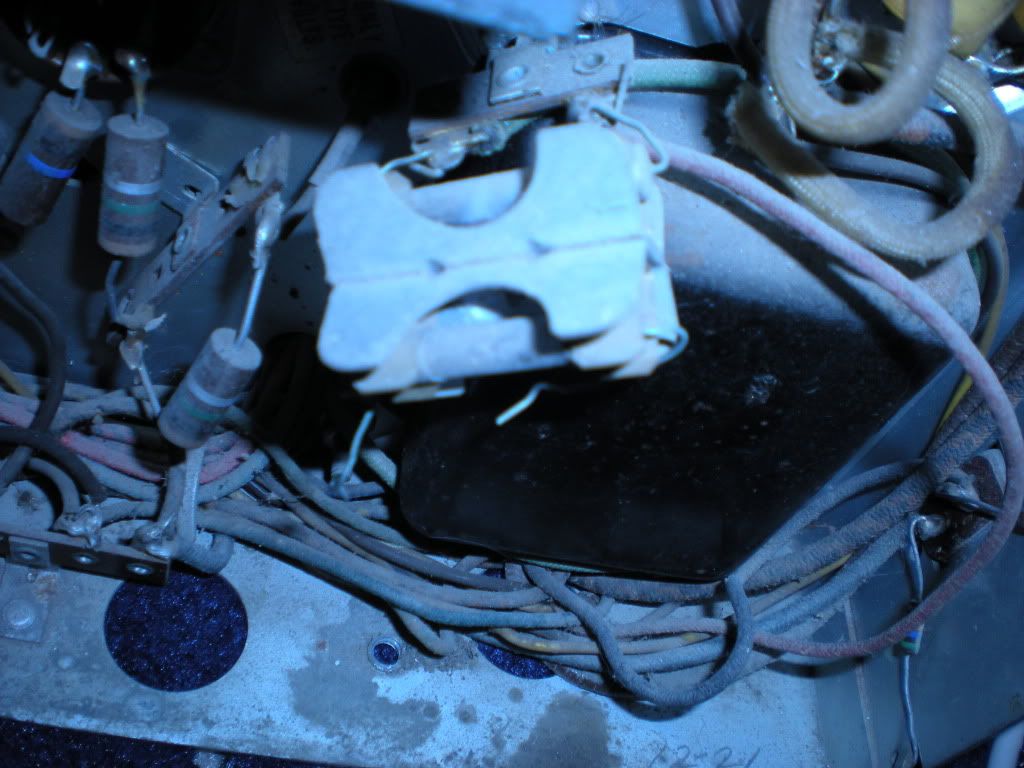

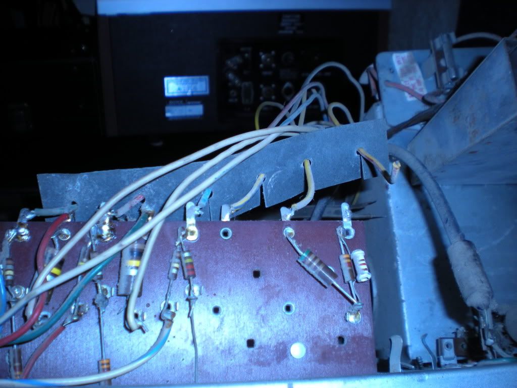

I pulled the chassis about an hour ago and brought it upstairs for examination and some work. here are the chassis shots...
The fly looks good with only a pinch of wax dripped.
A fuse was blown and a replacement was slapped in at some point in the past.
And this just looks like a hack job.
The set uses a metal color crystal.
There is minor damage to the IF board where the transformer got busted off.
One of the CRT socket wires is snapped off.

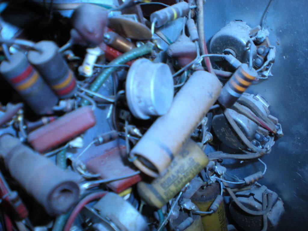

Been way too long since I updated my thread here. :shock:
I decided to pull the CRT a few days back. Here are some pictures of it.

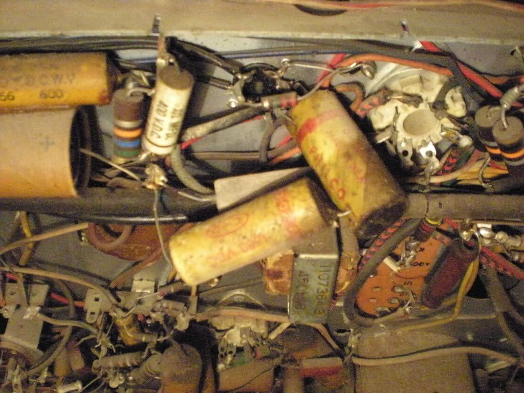

I've also slowly been cleaning 57 years worth of grime off the chassis.
I've been recaping too. Here is the completed IF board.
The ceramic cased ones I managed to restuff, but the rest had "bakelitized" paper tubes the ends of which my soldering iron could not melt or even soften! I had to double up to get one value of cap....I replaced a .056 with a .047 and a .01 in parallel ( I know this not wonderfully exact, but it is an improvement over the .068 maroon drop that was installed at some point in the sets past).
I finished replacing all the paper caps, and found that this set more closely matches the riders schematic than the Sam's folder from the ETF.
The only cardboard tubes left under chassis are either lytics or restuffed papers.
After doing all that it was very late and I decided to call it a night thinking I had reached my goal of ousting all the paper caps, then as my head hit the pillow I thought "Oh no! I forgot three! Oh well tomorrow then.", and the following morning I swapped them out. Now I can say all the papers are gone (though it is possible that some papers in mica-mold clothing may still be lurking).
I also remounted the IF shield after the recap.
I've disconnected the Doubler and B+ from the transformer and preformed a power up to confirm that the power xfmr is still good. The fillaments lit so it would seem that my power transformer is still good. :) :D :mrgreen:
I variaced the set with only the doubler caps and seleniums connected to the B+ winding on the xfmr (I unsoldered the B+ lines) so I can reform 2-3 of the lytics and check the seleniums under power simultaneously. the seleniums ran cool to "warmer than the chassis, and cooler than my hand" so I may be able to keep them hooked up for awhile yet. The Doubler caps seemed to reform well.....I had a mA meeter hooked up between the B+ Xfmr winding ,and the two seleniums (this was the most convenient place to do so because all I had to do was pull out a fuse) The AC current varied with line input, but the DC seemed to vary with the reforming of the lytics. I reformed the doubler lytics by turning up my variac until the DC current was at ~1.5mA and then waiting until it dropped to ~.5mA I was able to continue this until I got to around 495V at the output of the doubler. At that point and above the current would stay around 1mA and not drop. The output voltage of the doubler is only supposed to be around 383V so I think the doubler is good enough for it's intended operating conditions.
I've been continuing to clean the chassis as well.
I thoroughly cleaned the inside HV cage including removing the HV rectifier cup for a cleaning.
The place where the HV rectifier cap connects to the fly was missing most of it's wax and kinda loose so I took some dripped wax and built up the wax around it for added support. I was concerned that the the connection on that lead was open so I checked the resistance between it and the HOT cap lead and got within 10% of what sam's lists that resistance value to be which is a good sign.:) I also for the briefest of moments touched the barrel of my soldering iron to the wax on the HV winding of the fly to melt the outer layer of wax in order to fill in some small cracks in the wax coating.
I replaced the HV cage lytics as well. I replaced the 20uF 25V caps with 22uF 250V replacements, and the 5uF 25V with two 2.2uF 63V Radio Shack "how the heck can new caps have some ESR???" specials connected in parallel (I'll likely change these turkeys later for a better part).
Here are some pictures.....More can be found in the link from the first post in this thread....

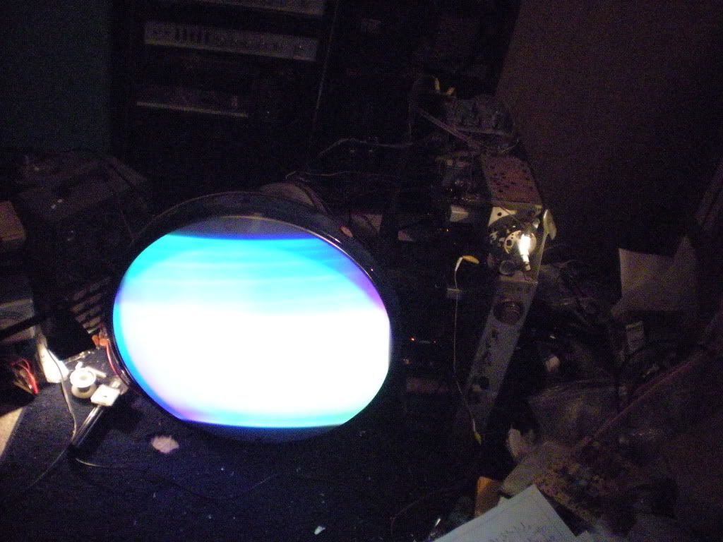

We have got a RASTER!! :D :mrgreen: 8)
About an hour ago I finished preparations and proceeded to do a full power up including the FULL horizontal stage. The best replacement for the bad 11K ohm 10W screen resistor for the HOT I could find was a 10K 7W, but I figured that it would last long enough for a full test, and I was right.
After putting the sub in with the top lead of the HOT still disconnected I read 110V. Sam's calls for 160V at the screen. I also decided not to sweat over not having the vertical osc. running the other day as I noticed that the plate of that tube gets it's voltage from the boost line, and thus would not work unless I went ahead and connected the flyback up to the HOT and damper.
The HV was only 15 KV (and falling) on the second test (I was too excited on the first brief power up to read the meeter). I figure that with low HOT screen grid voltage and all new tubes across the board that this is not too bad for a first power up.
I did not have sound during the test which I attribute to me messing with the tuner setting earlier in the day. This set may possibly have video for all I know.
This was the last task of the night. I'll see if I can do more tomorrow.

 Post subject: Re: RCA CTC4: the barberized Seville. We have got a RASTER!!
PostPosted: Jan Mon 02, 2012 6:33 pm
Posts: 2935
With the HOT plate disconnected, the screen will likely draw excessive current. That would cause the screen voltage to
be low. You may well find the screen voltage to be closer to correct with the plate connected.
PostPosted: Jan Mon 02, 2012 7:32 pm
Posts: 9173
Just disconnecting the plate cap on hot will shorten the life of that tube.
It draws excessive screen current. Always pull hot tube to disable hv.
What is that test picture tube you have on it?
That set is meant to put out considerably more hv than I think that test tube can safely handle.
Is that a bw tube?
Or, is it from a modern projection color set?
In either case, alot of differences.
Looks like important parts are good.
Have you replaced the SELENIUM rectifiers, yet?
Bill Cahill
PostPosted: Jan Mon 02, 2012 8:13 pm
Posts: 397
Location: Pewaukee, WI
Thanks, I'll recheck the screen voltage with the HV going soon.
That is NOT a test CRT it is a 21FJP22, and it is the tube that I will use in the set until I can lay my hands on a good 21AXP22. Those are both color CRTs BTW.
There was no picture tuned in...just a blank (albeit impure and colorful) raster which my camera washed out.

We have now got VIDEO and sound! :o 8) :D :mrgreen:
Well I got my signal issue sorted and did another power up. As suggested I meetered the screen of the horizontal with the plate lead of the HOT connected, and I got 150V. This is close enough to the 160V sam's calls for that I will not loose sleep over the resistor that is in there(at least for now). When I first powered it up with signal the video was so weak I almost missed it. I did see it though and synched up the horizontal and vertical. Even with the contrast maxed the video was really weak, and the deflection would not keep synch so my mind went straight to AGC. The control was near max already and maxing it did not yield enough improvement so I started jiggling tubes in their sockets and it was the second IF tube that fixed it. In fact after shifting that tube to a better position the signal was overloading the set. A quick readjust of the AGC and all was well (except for the dead color circuits and a some other bugs).
The HV stayed at about 20KV this time and adjusting the regulator would only reduce it. After about an hour of operation the fly was pretty warm.
I think it is about time for me to read and preform the Sam's horizontal adjustment procedure on this set....
The screen controls were sticky and the red is stuck. Between this and the dirty tube sockets I believe that it is time to get some DeOxit and start cleaning controls and contacts.
WOO HOO! Just a bit more and it will be working like new again!
