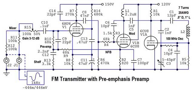

I'm working on a reactance tube FM transmitter and while not completely finished it's far enough along I thought I'd share and solicit comments.
The basic Osc/Mod topology was plagiarized from an old RCA patent, which used a 6AN8, but I intend to eventually use 'dollar days' tubes, meaning they cost a buck each from on-line suppliers. That's where the 6CU8 comes in but a 6BL8 is what I had on hand and is used in the breadboard. The preamp is a 6AU6 but 'dollar days' candidates would be 6AG5, 6BC5, or 6CE5. Bias tweaking would likely be necessary with the alternates (I use 470 under the 6BL8 rather than the shown 820 for a 6CU8 and 15K under the 6AU6)
V1B is the reactance tube with V1A the oscillator. (The unlabeled resistor on C4 is a dummy to make spice work)
The 6AU6 preamp serves as both 75 uS pre-emphasis and to reduce modulator distortion via negative feedback from R2 sensing modulator current.

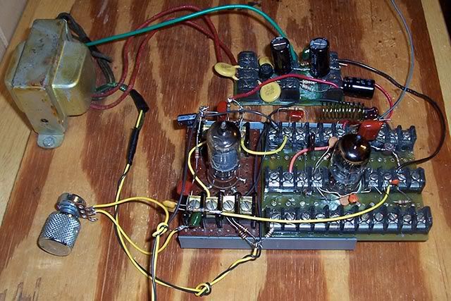

And the not so pretty breadboard
I would like to add an antenna winding but the thing radiates well enough for at least a 30 ft range as is. That's not a 'tested limit', simply how far away the radio I'm using is located.

It's always interesting to see what other people come up with for FM transmitter designs.
Through experimentation with my "old band" transmitter, I found that routing a piece of bus wire about half way around the coil provided plenty of coupling without causing too much frequency shift caused by the antenna. It is grounded on one end and the other end leads to a BNC connector on the chassis apron. Using two 18" test leads in series as an antenna, coverage increased from 30' to well over 300' using my Radio Shack Patrolman (low-band VHF) radio.
For me, the trick for getting low distortion was to experiment with the value of the reactance tube cathode resistor. Getting the carrier to swing symmetrically around the center frequency was observed on my Hameg specturm analyzer as I changed it's value. I also discovered that it did not want to be bypassed.

Interesting design, and people will certainly like to experiment with this.
I'd stay far away from a 6CU8, it's one of the worst tubes ever built, right up there with the legendary 6GH8 as far as a high failure rate goes. Every TV we ever got in the shop that used 6CU8's they were always bad and a year later they would be bad again.
There are plenty of other choices for triode-pentode types that you can get cheap. You could even rectify the filament supply to get just a bit higher (DC) voltage and use series string tubes that no one wants like 3AU6 and 4BL8 or 5EA8, whatever you can find that has the right filament current to run in series.

Well, I think I have antenna coupling now. I say "think" because just the air coil radiates and without a field strength meter it's hard to tell how much there might be. All I can say for sure is if I put my scope probe near the coil I pick up signal and if I move it near the wet noodle antenna (not the final antenna intended) I also get signal, so 'something' gets to it. And, at least, there's no frequency shift nor does it flat kill the osc like before.
I wound a new coil on .3125" (ballpoint pen body) to up the turns a bit and put a separate same size single turn at the end spaced about the same as the others. Or, rather, it was to be a single turn but I miss judged the terminal block layout and, in bending it over, lost a fraction of the turn. I don't think it matters.
I'm still not sure why the other one didn't work but I never calculated the inductance of that large half turn so maybe it was too much.

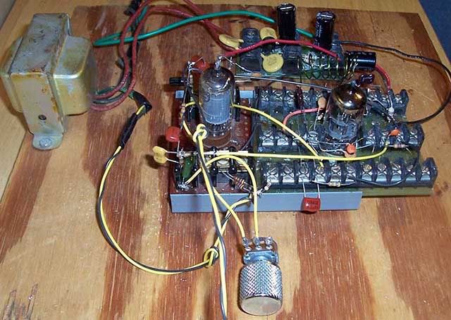

Okay, here's the current breadboard with the 5/16" coil and 2 turn antenna coupling, plus a couple other tweaks
You can see the two turn antenna coupling coaxially to the right of the primary coil with my blue wire wet noodle flying off the top.
R13 was increased to lower the pre-emphasis shelf a couple dB to reduce peaking above 15 kHz but I'm not sure it matters. The problem is pre-emphasis, with any FM transmitter, accentuates HF (it's purpose) but tends to create impulse noise on problematic source material, in particular if there's clipping in it. I'm trying to reduce that effect by limiting how much gain pre-emphasis continues to apply above 15 kHz and trying to avoid complicating things with a gaggle of filters.
Preamp maximum gain was increased (R11 and R12 decreased to 10k) to better accommodate cell phones and small MP3 players.
L1 is 10 uH, as opposed to the originally shown 2.2 uH, R2 is 470 and V1 shows the breadboard's 6BL8.

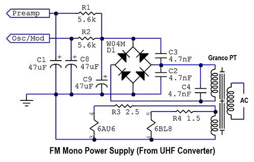

B+ voltages reflect how they roughly come out when using a Granco UHF converter transformer full wave rectified into 47uF with separate 5.6k/47uF filters for the preamp and reactance/oscillator sections, as previously posted.
Edit: corrected B+ on mod/osc section. Also, I don't think the gain adjustment is necessary anymore but it's still on my breadboard and might be useful for cell phones with large volume steps in order to fine tune deviation.
