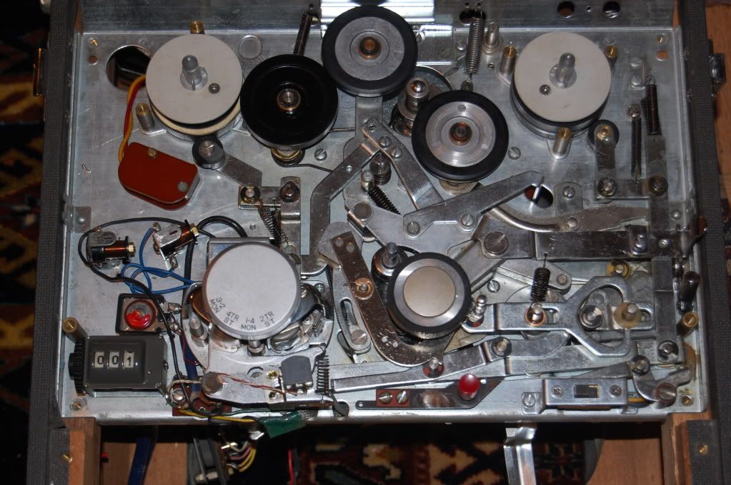

You're welcome. Yes the mechanics will need all the old grease cleaned off in order to be done right. You can then use most any modern grease unless there is a prefered type for this.
Once you receive the pinch roller the tension should more than likely not need to be adjusted.

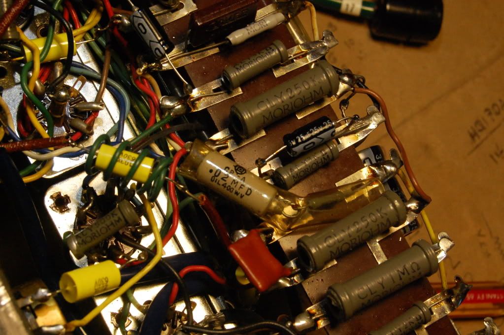

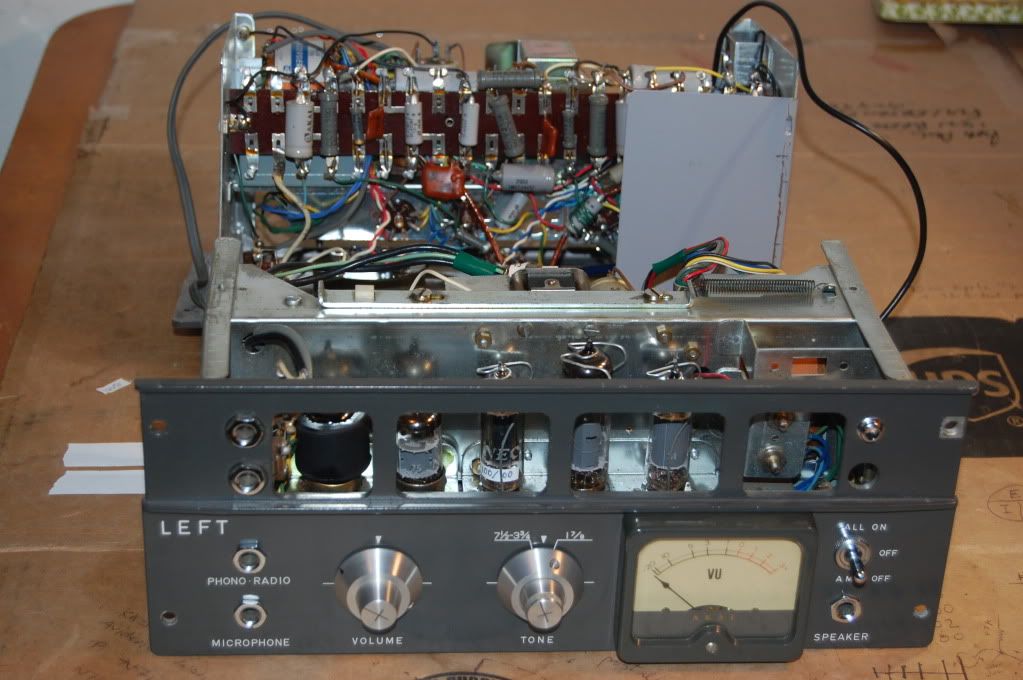

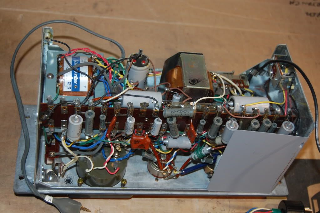

I pulled the amps out of the cab and thought I would show them off. Basically, they were really clean and origina all the tubes were NEC branded. I'm still waiting on a few tubes, some caps, and a pinch roller for my restoration so not much I can do right now. The EF86 tubes have thick tight fitting rubber sleeves on them. I suppose that's to lesson harmonics or something? Not sure if I have seen that before.
On thing that does puzzle me is the type of resistors used in this set. I hope the reistors are fine since I don't have any stock of this type labeled "CLY MORIOHM". I will at least have to learn the new code designations. Any opinions on these grey resistors and do they have a good reptation or are they prone to problems? I notice all values are different than I'm use to seeing as well.
The mechanicals:

Concerning the gray resistors I recommend checking a few in different parts of the circuit. If some are out of tolerance then I suggest replacing all the resistors.

I'm almost finished replacing the caps, it's been a big job and luckily the resistors all checked out good. Also received a nice pinch roller from Mr. Tube Radio. I was suprised to see a few places where resistors and caps are placed inside bits of vinyl or plastic tubing. Do you suppose I should keep this in place when I change out the cap?

Yes the tubing prevents the leads from shorting to another terminal.
