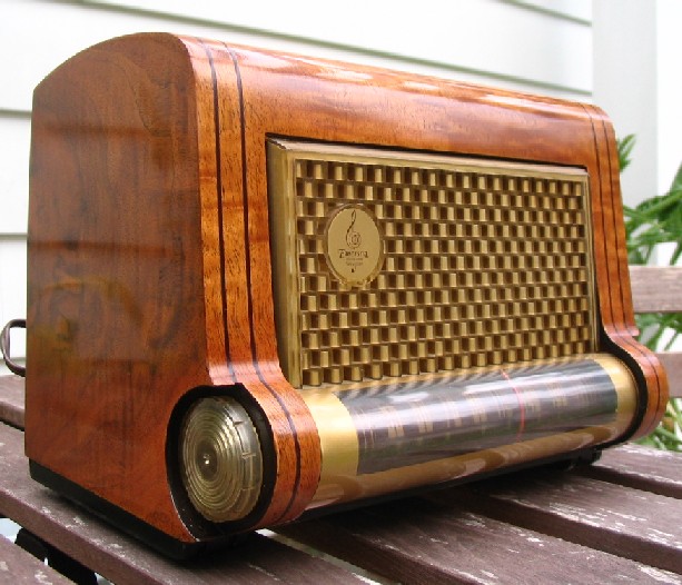

Jack's last couple of paragraphs describe what I do. I usually grain fill at least twice, and the wood is so smooth that it shines without even having a finish on it. I then put a few coats of semi-gloss lacquer on, then rub it out. It comes up to a nice high gloss, but doesn't look real plastic-like.
I use spray can lacquer, and frankly with the Watco stuff, I haven't noticed a huge difference between the gloss and semi-gloss anyway. If the surface is incredibly smooth, both are very shiny (at least to my eye).
Regardless...since everyone uses different materials and different procedures, I should probably ammend my observations above...if you're laying on 12 coats or something similar, I can't say for sure that putting gloss over semi-gloss is going to get your desired result.
This is one that I did as described above, it is semi-gloss lacquer, and then rubbed out and polished.

Beautiful work, Did you use stain or toner for that color? what color is that?
