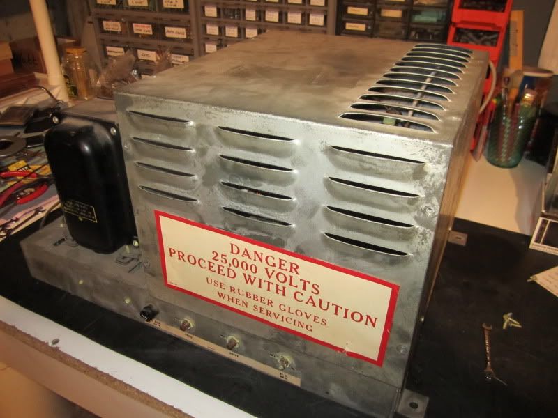

Of all the vintage TVs I own, only one is inoperable - the RA-119 DuMont Royal Sovereign.
I've decided to start the resto process on the chassis. Fortunately for me, the cosmetics on the Teleset are already superb. In fact, out of all the TVs I've acquired over the years. This one has the best cosmetics, hands down.
I've started by recapping the HV Chassis.
"Danger, Will Robinson!"
All the Tubulars measured higher to much higher than factory tolerances. I restuffed them all. I checked the axial Electrolytics under the chassis, and they are either within or a little higher than factory tolerances. I'm tempted to retain them, as they look like they can work fine, and, they are factory. I can't restuff them like tubular caps. But all that Voltage...I don't know if it's smart to retain them...
All the Wire Wounds in the HV Chassis check out fine. I checked a bunch, not all, resistors and they are fine. The Tubes I'll check on tomorrow.

I would not even consider using any original axial electrolytics. Especially not with that unobtainable power transformer that would cost a small fortune to have duplicated should it fail.
They can be restuffed, you just need to work carefully and be creative. This may involve making a new end where the positive connection is located and gluing it back into the case. I have also seen these done by cutting the rolled end of the cardboard tube, sliding it off, cutting the aluminum case open, restuffing, then gluing the cardboard back onto the two halves of the case. Not impossible, probably easier than restuffing regular multisection cans.

I have a new 27RP4 CRT. I'll make a mask for it.
I will restuff all the Electrolytics. Canned multi-section lytics I've done before, they are no sweat. It's the tubular 'lytics that will be tough. I'll figure it out... 8)

I only rarely rarely restuff caps, but I consider axial tubular electrolytics the easiest:
1. Remove cardboard wrapper
2. Saw cap in half
3. Remove innards
4. Attach new cap to existing pigtails (either internally or with a tiny hole from inside to outside)
5. Tape cap back together (black electrical tape will do, aluminum tape a little nicer and stronger)
6. Replace cardboard wrapper
Tom K6VL

It's the paper wrapper that hangs me up.
Do I uncrimp the end, or just slice with a razor blade along the circumference and slide both ends off? I don't think I can recrimp it so it looks factory perfect.

I have tried to recrimp the end of the cardboard and it never looks right, so I just use a box cutter or single edge razor blade to cleanly slice the crimped end off. So the finished cap only has one crimped end, but who's going to care if the cardboard sleeve can be salvaged?

Sure you want to do that? Data sheet for the 27RP4 states maximum anode voltage of 20kv, the sticker on your HV supply clearly says 25...
Plus a rectangular tube just wouldn't look right, you might try looking for a 24AP4. Then it would at least still be a large metal cone picture tube, although still not the right size and not enough anode voltage either.

I'm going to reduce voltage to the 27RP4, I know about the different voltage specs for each CRT.
As far as the mask is concerned, I'm going to reduce the double-D mask to fit the 27. It will look good. And I won't harm the factory mask.
...unless a 30BP4 turns up. I have time.
