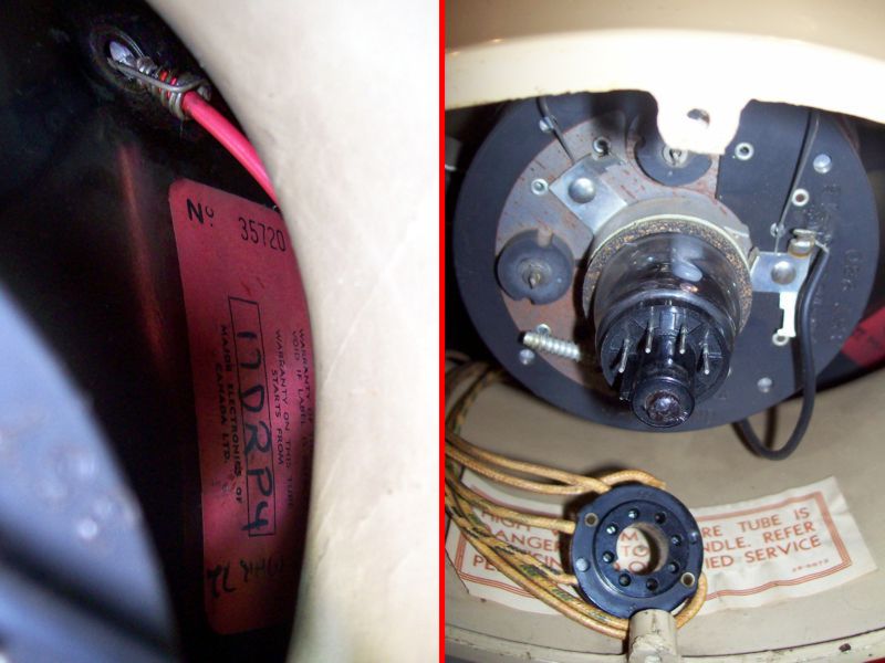

Do you still have that other Princess?
You could pull the tube assembly off it without too much difficulty and see if it works on this chassis, or vice versa.
Your CRT seems to have a rebuilders tag with a date of 1972 on it?
The two other now working Princesses have a 7-pin socket and Si rectifiers, whereas this one has a 8-pin socket and a 5U4 tube rectifier. I could swap the whole swivel screen including wires, which means taking the nicely working thing apart again. But I have two more not tested Holidays, where I could try to swap the picture tube?
Interesting, it says indeed "MAR 72" and the tag is hand-written. I wouldn't be so clueless, if the set wouldn't have worked before recapping. I will get a HV tester tomorrow, and see if the anode voltage is ok. Thanks for co-thinking.

chriswch2003 wrote:
The two other now working Princesses have a 7-pin socket and Si rectifiers, whereas this one has a 8-pin socket and a 5U4 tube rectifier...
Do you mean it has 8 pin positions but one is blocked out or do you mean there are really only 7 positions on the socket ? Pin 2 and 6 are both connected internally to G2 in the 17DRP4.

bandersen wrote:
As the picture above shows, the socket has 8 holes, with two pins (2 and 5) not contacted, the picture tube has one pin cut (5) and one (2) internally connected to pin 6. The 7-pin picture tubes used in the other two Predictas have 7 pins and 7-pin sockets.
Odd. I wonder what picture tube they are using ? Could someone have rebuilt a 17DRP4 with a 7 pin gun assembly and modified the Predicta socket ?
