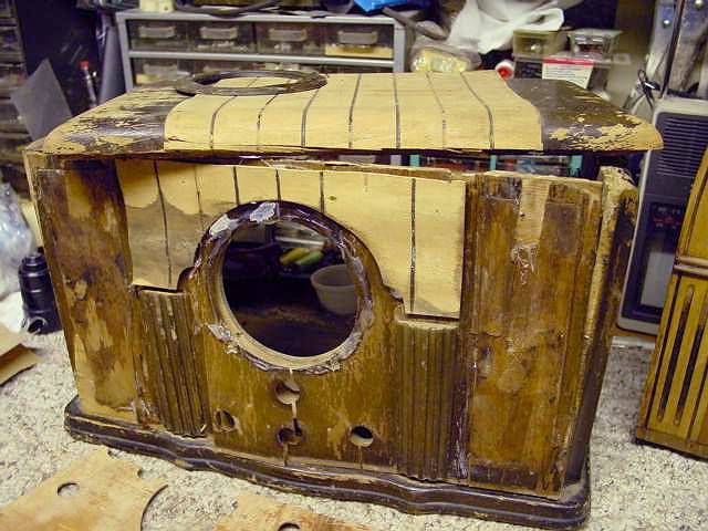

I picked up this Tiffany Tone Cathedral and was curious if any one could identify it? I will need to learn to either reconstruct the cabinet or find one that will work! The chassis looks worse then it is after i cleaned it up a little. I think it's an RCA chassis but the decal is 99% gone!

I would save a few scraps of veneer , the tubes and knobs and toss the rest .

I'd definitely try for the rebuild of the cabinet. Front face and lattice work, no problem. The rest of the cabinet will have to be redone obviously, probably dismantle starting with the base mouldings.
I have a Philco 60 that was in the same shape. I explored using forms and templates to get the shape right using new "bendable" plywood underneath. I was planning to using the original veneer too as it was in ok shape. I put the project on hold for now, but I had a good idea of how to come along on it,
Your veneer looks intact too.
You have the shape of the arch based on the front panel. As long as it remains the same front to back, during the rebuild.
I would not look for another cabinet. You may find something similar but it wouldn't be right. With the TiffanyTone name I would want everything to be like original, as much as possible.
As for the chassis, I hope it hasn't been hacked too much and the transformer and field coil are ok. Speaker recone, naturally.

I say send the cabinet to Gary sence he likes to restore those . I have in the past tried to save cases that bad . All of the wood parts and layers have shrunk and warpped and will not fit back right ever again . The veneer over the hump would be impossible to clamp back down and look right again . There are 2 trim pieces missing from the front . The entire grille is delaminated with inner layers shrunk and warpped .
If you are not a master at wood restoration or are just plain in need of a very long project , not to mention the chassis which will never ever be original again and will either be rusty or repainted . I just cant see it . It will be so unoriginal when you are done it will not be worth its real value anymore if you expect to sell it as such .
Send it to Gary . I want to see a thread on him restoring this one :)

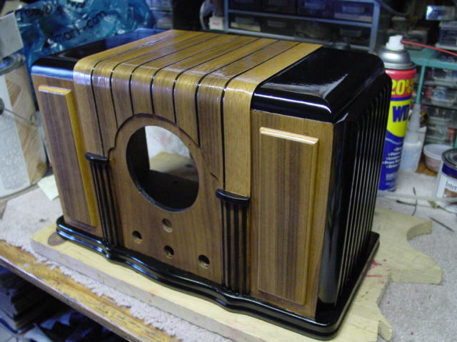

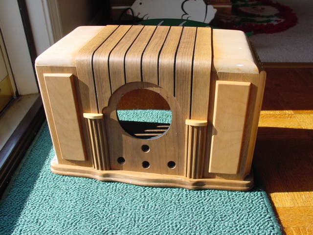

Thanks for the vote of confidence Ken :) If it were my set, yes I would do it. I know it will never be totally original, but what's the alternative?
If it were smashed and flattened, then I'd say get rid of it.
The missing pieces are probably just a curved piece that appears on top of many fluted columns. Just a rounded piece that is easily made.
That's the least of the worries. The fretwork can be glued, pressed flat. And alignment issues can be sanded.
Chassis is bad, but we have seen worse. No set will ever be totally original, but I feel they need to be saved. Painted chassis, fine. Not original but it was at one time. Resurrected is ok in my book.
While I probably will not be working on the Tiffany Tone, I did resurrect a Packard Bell 45M once, some may not have see the before and after photos. Kind of an uncommon model too. The person I was biding against was going to trash the cabinet and install the chassis in another cabinet.
I am happy I save the cabinet, as that is one more in existance. No , it's not totally original but that's ok. It takes up a space on the display shelf really nice :)
Thanks again Ken, I remember you complimented me on that set I did. :D
You are an inspiration . Not only is the work you did perfect that radio is a total beauty .. just look at it ! what a great choice of coloring .How did you get that veneer bent around the front without breaking it ?
I have kept that in my mind all this time, and I appreciate it :)
Gary Rabbitt
