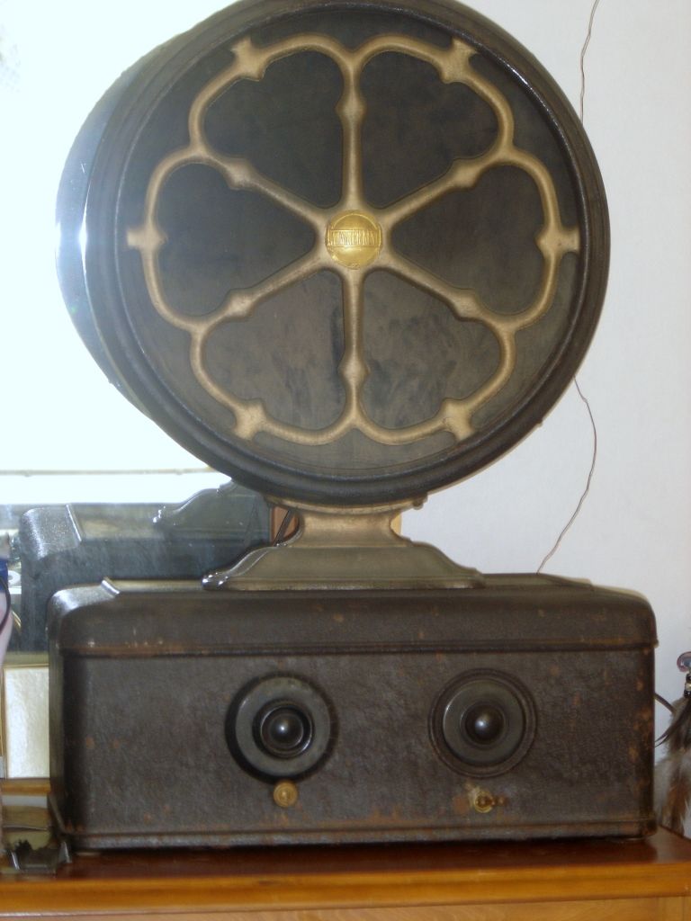

I will soon be refinishing my A-K Type "E" speaker, using metallic gold for the base and "spokes" and Krylon dark brown camouflage for the rest. Only problem is, I can't seem to get the fabric out of the holes in the backing. It is still in good shape and I don't want to wreck it, but it is glued in solidly. I'm worried that masking tape will be too hard to remove. How can I paint around the cloth without getting paint on it, and still get to the edge of the metal?

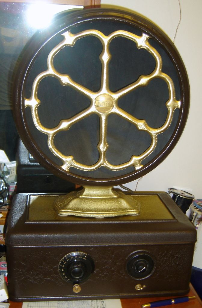

Okay, I seem to have found a good, working method. I cut five discs out of cheap photo paper, each one 4.300" across, which is big enough to cover the fabric and sort of "snap" into place under the edges of the holes. I'll post photos when I have both the radio case (A-K 40) and the speaker done, hopefully some time this week.

Done, and looking good (to me, at least...)
Before:
After:

OOOOOOOOOOOOOOOOOOOOOOOOOOOOOOOOOOOOOOOOOO nice :P
Makes me want to redo my AK-40 and model E speaker. Only problem with mine is in some spots on the radio I would have to recreate the wrinkle finish.
