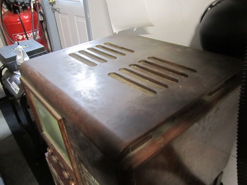

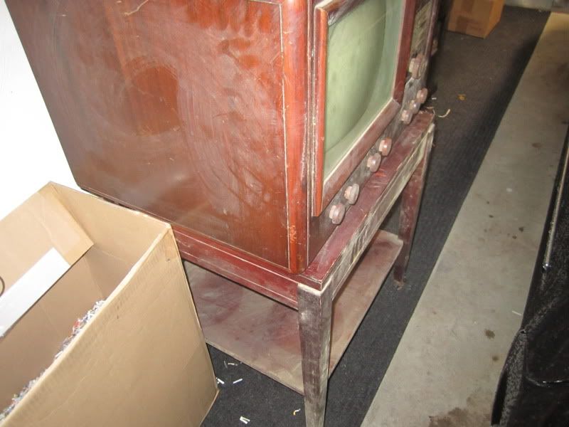

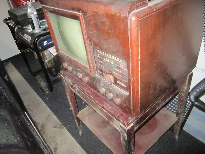

Just picked it up. What's interesting is that it came with an (apperently?) matching Table. I didn't know Andrea offered a table option...
It appears complete, including the back cover. I tested the 12JP4 and it's as Dead as the Proverbial Doornail. Of course the Brightener was a tip off.
Overall, the finish is all there, with a few minor boo-boos. After breaking everything down, I believe I can bring the origional finish back to more than acceptable appearance. It looks like mahogany.
Picked it up for 50 Bucks. 8)

I'm glad to acquire this set, and for so very little $$$, and the fact that it has the rare table option. I've had my eyes peeled for an early Andrea for quite some time.
It appears to be completely unmolested, right down to the cellar mold. A nice, thick layer of dust covers the chassis, tubes, etc. No signs of animal infestation. Underneath the dust is a rust-free chassis.

No marks or stamps on the table, but the way it's sized and styled I would be surprised if it wasn't an Andrea accessory.

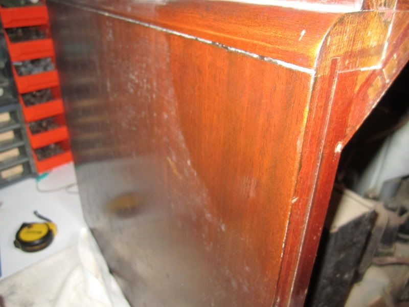

I made a quick pass at a corner of the cabinet, and it looks like it will bounce back:
Good Ol' Howard's... 8)

I wet sanded the cabinet with Howard's and some 600 grit emory paper, and boy, is it bouncing back. Gentle sanding with the grain, even pressure and constant checking by feel. Only a few minor blems, or "beauty marks" as I like to call them (they add character) will be left in the finish, which is becoming satiny smooth to the touch. All the checking and cracking in the finish is dissapating nicely.

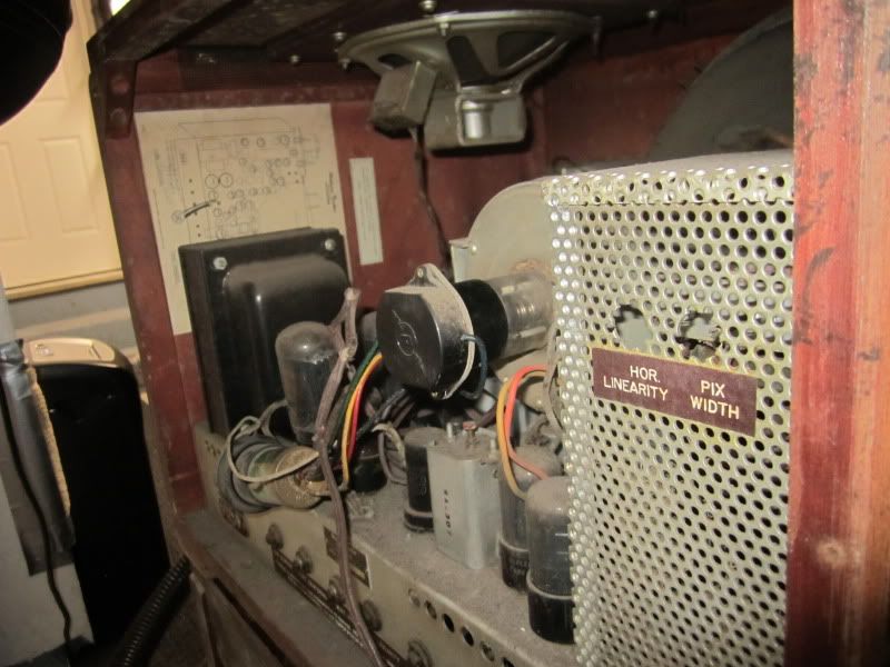

The Chassis has beautiful cad plating on it. It is buried in dust, which I will blow away with compressed air after I remove the CRT. It will look good restored and back inside the cabinet.
The CRT is origional to the TV. It's Part # and Serial # match a notation made by the factory on the inside cabinet schematic. Too bad it's dead. Perhaps I can bring it back... 8)
