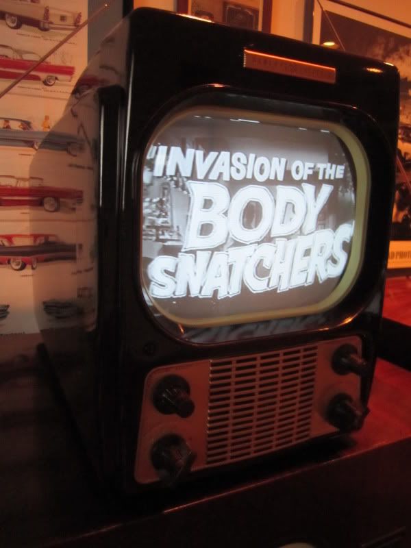

I purchased a GE model 805 "Locomotive" at the CC-AWA Conference in Charlotte.
Missing one small inner knob - see lower right - anyone have a source?
Two screws are exposed on the front under the CRT - is something missing?
This is the first time I have messed with a GE 805 -- What am I getting into? Got any tips?
Bakelite cabinet has no cracks, it is dirty. Need to utilize Bandersen's cleaning and polishing techniques.

I believee those two screws hold the front to the case. Front is also bolted to chassis inside.
What are you getting into?
Two words come to mind.
"Good Luck!!"
After all the hair pulling is done, they play o.k., but, they ain't no Dumont!!

They are quirky and rather difficult to work on due to the very deep chassis. Resistors and caps are mostly mounted on long terminal boards which make access to some connections very hard. They also have a lot of electrolytics and physically mounting the smaller replacements that are available today requires adding terminal strips to connect them to. There are a few other problems to deal with such as the globar filament resistors inside the HV cage, and a tendency for front panel controls to fail.
The sets work OK once restored but are not among the best sets of their era. They don't compare to an Admiral or RCA for example. The collector appeal is the neat design of the cabinet, not the functionality.

The screws holding the front on are wrong, they should be a dark color and I think they are supposed to be Phillips head. I've never seen anything covering the holes on these.

Here's mine. Restored and playing:
"You're next!!!"
Don't be afriad to restore the 805. It's a simple series set. Lots of lytics, yes, but the set does look cool.

Correct. The phillips heads version of this screw, a 10-24 thread, was impossible to find.
I used a hex head anodized black 10-24, about an inch long, I think. You need four. Two on the bottom front, and two on the front, where those silver screws in the pic reside.
