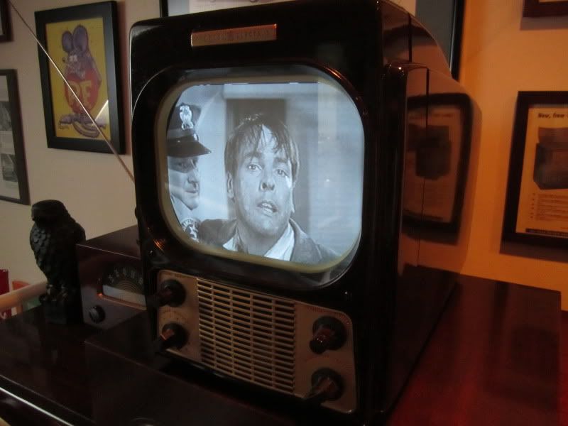

Give me some advice on what you would do to improve appearance of this grill:

Here is a pic of my front. I had never thought about taking that gasket out until I saw yours. I think I will give that a try.
Doug

The brass front area was likely coated with clear lacquer to protect it from tarnish, so lacquer thinner should take any remaining clear off. I'd try a magnet to it in order to determine if it's solid brass. If it's brass plated you should still be able to gently polish it with something like Brasso. As long as you don't soak it in thinner, I doubt you'll wipe the red lettering out of the recessed areas. If the red does come out, just leave it until you re-coat it again with clear lacquer, then go back and wipe some red acrylic paint in the recessed lettering. Any smears you can clean up with water before it sets up.

I disassembled the entire cabinet. On the Front, I removed, and buffed the GE rectangular logo. The light green rubber gasket was also removed, cleaned with lacquer thinner to remove surface dirt and oxidation, then treated with 3M Rubber Dressing. That will make it pliable for another 50 years.
My brass grille/escutcheon was all corroded, so I wet sanded it all level, then shot a nice coat of gold lacquer, followed by a clear coat. After a few days of hard drying, I wiped in some Tamiya XF-7 Flat Red, which is a dead ringer for that faded red that GE used.

I believe the grill is Solid Brass. I put a magnet on it but it would not attract. In addition, I scratched the back side and it was shiny brass colored.
Thanks Kevin. Last night I tried a quick wipe of Laquer Thinner using a cloth but the protective finish would not come off. I think I'll try some 0000 steel wool dipped in the Laquer Thinner this morning and see.
Then I'll take Lee's tip and try to locate Tamiya XF-7 Flat Red paint to reapply the lettering.
