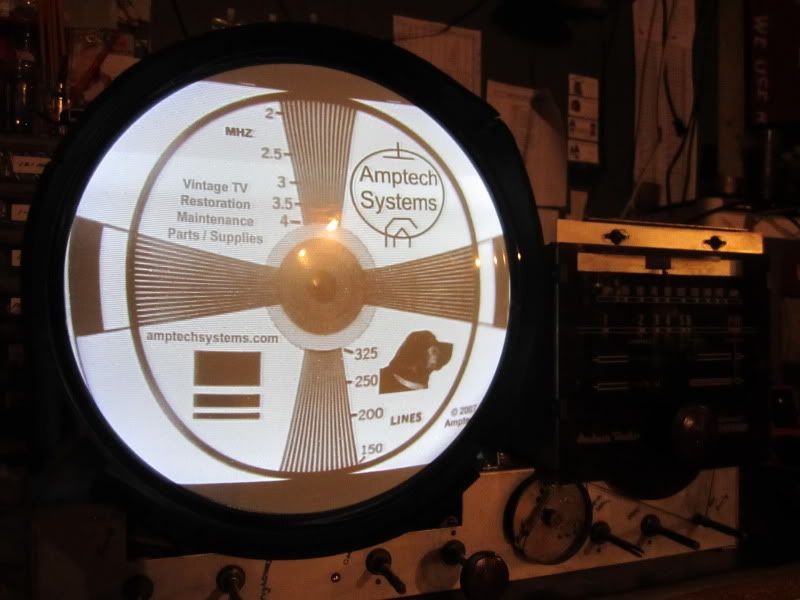

OK, here's the latest:
I installed the NOS 12QP4. I can only get a good level of brightness with the Focus Coil as far forward as the slots can go. Maybe I can get it brighter, but, the stops won't allow me to go further.
I'm using a single magnet Ion Trap, a Philco. It seems to work ok.
I have the Focus Control all the way clockwise, and I can't get a sharp focus on the screen.
Deflection is ok.
What now? 8)

I don't believe I'm getting peak brightness with the Ion Trap (it's the best performing of the bunch I have) because when I attempt to adjust Screen Voltage (R39 Control in Riders) with the Brightness Control (R118) set to 30-35V I can't get any illumination at all out of the CRT.
Still have the Focus problem as well. The Test Pattern squares up nice. 8)

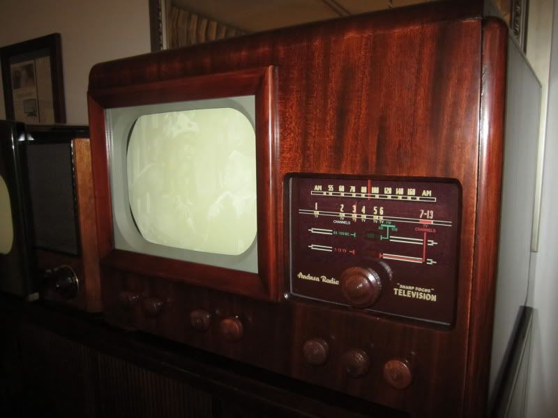

Tacked on a 7500 ohm 10W ww resistor onto the Focus Control to extend it, and I finally got a sharp focus with a little extra range to spare.
I set the Ion Magnet and Picture Tube Screen Control for the 12QP4 to the best setting possible. It looks mucho better than the dying 12JP4 that it came with. Decent brightness and contrast, and no ion burn to stare at, so I'm happy with it. Sounds good, playing thru an old DuMont 5" driver. I just sent the stock 7.5" loudspeaker out to be rebuilt.

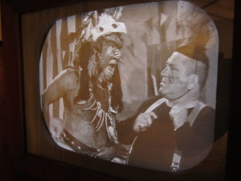

OK, She's done. Done done...
I found a large, single magnet Ion Trap that works fine, with the Focus Coil cardboard end cap installed. Picture is as bright and clear as I can make it. Probably pulling about 3.3 megs bandwidth. Not a bad picture.
Curly's back On The Air. Situation Normal.
All back together. I think it's finished.
