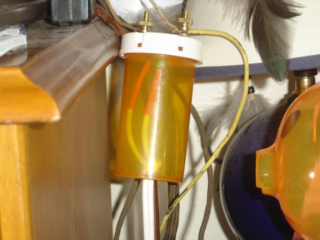

I decided to try my hand at making a modernized version of the 1920's "lamp socket aerial". It consists of a pair of .001uF, 3 kilovolt capacitors (overkill, I know, but it's what I had), each one soldered to a separate lead of a cheap extension cord with one end cut off, with a pair of "binding posts" made of hardware store 8-32 brass screws, nuts, washers, and thumb nuts, all mounted inside an old pill-bottle with a child-resistant cap (keeps my kids out of it). All leads were carefully insulated with heat-shrink tubing to prevent accidental shorts:
It works surprisingly well! With the binding posts just connected to the antenna and ground posts of my Atwater Kent Model 40, performance is no worse than using a wire strung up around my room near the ceiling, and actually a bit more quiet. Adding a ground wire to mains ground (my only grounding option at present) made things much noisier due to increased RFI, but also increased sensitivity many times over to the point where I was able to pick up a station that I was never able to pick up on this set before.

I don't consider the 3kV caps overkill for that application. I think you were wise to be conservative.

telephone house wiring works as well without high voltages to be concerned with
.001 to any lead for best reception. also gimmick twist coupling works.
if using the live pair it is already lightning protected :shock:
