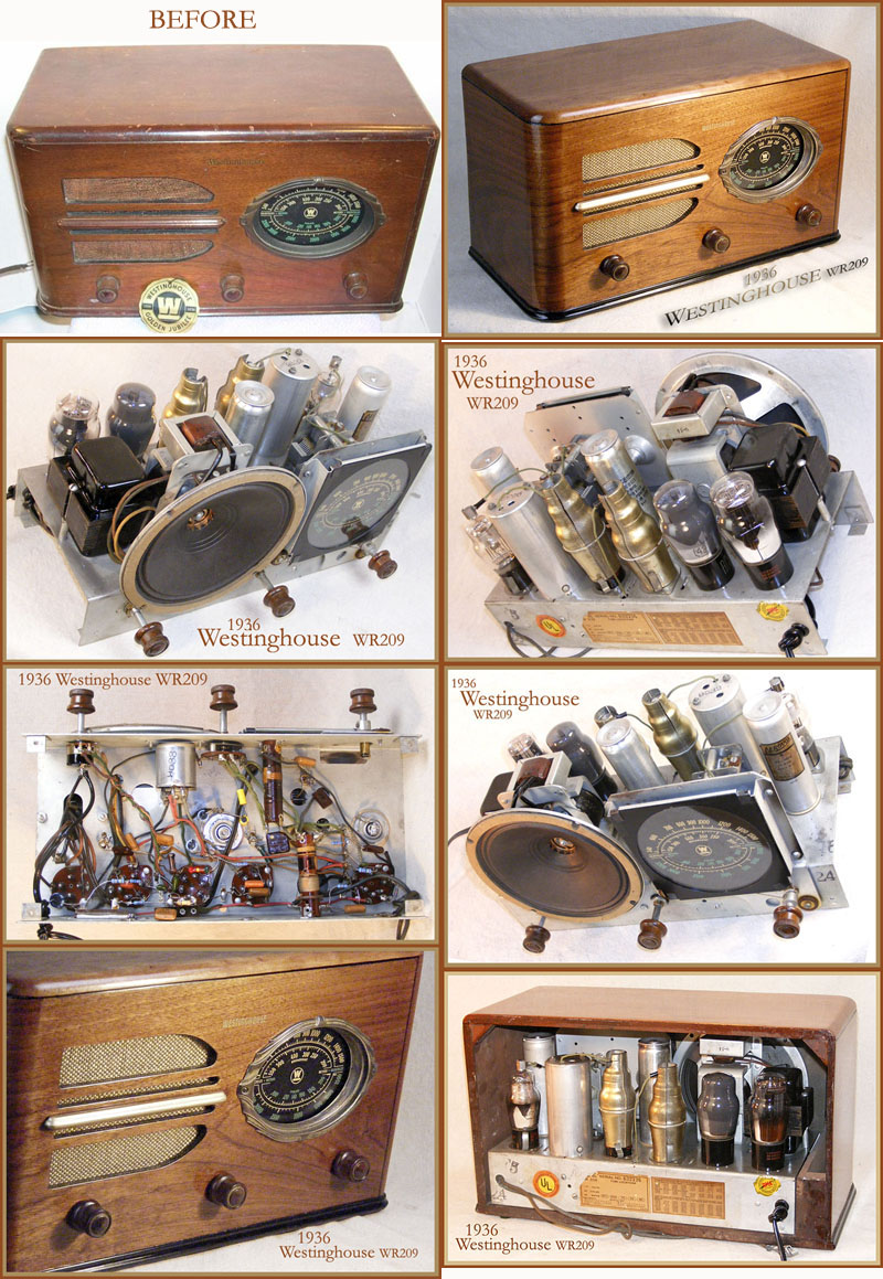

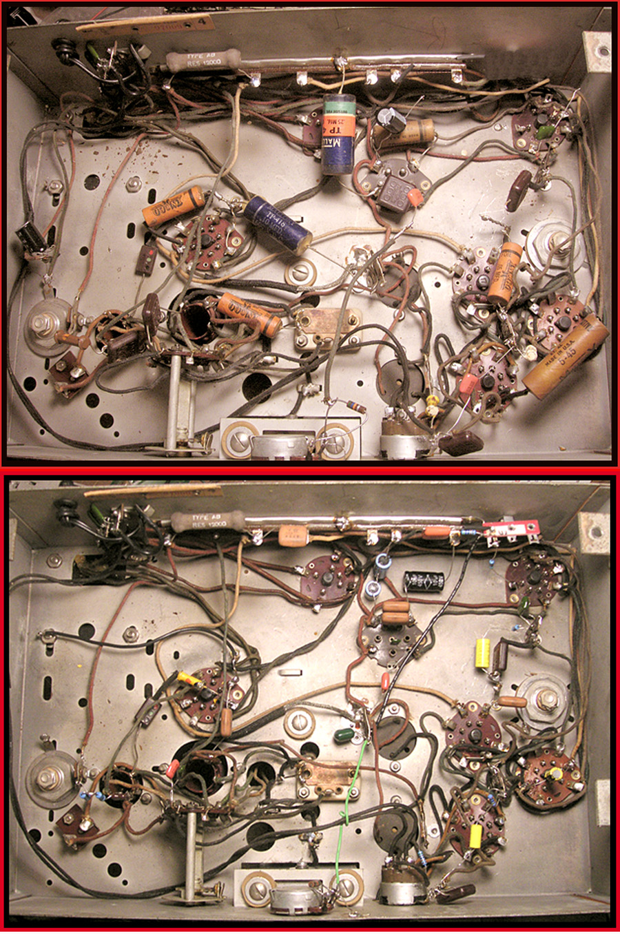

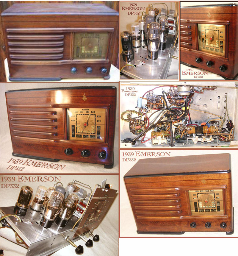

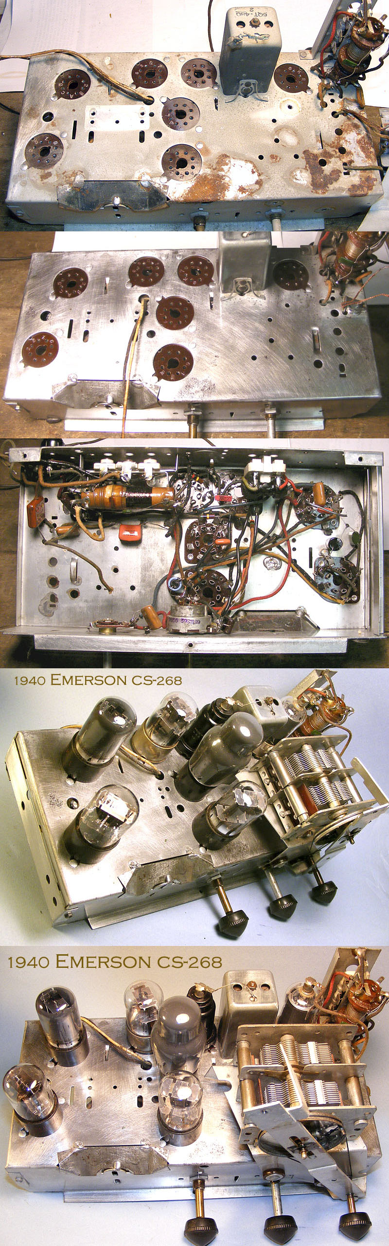

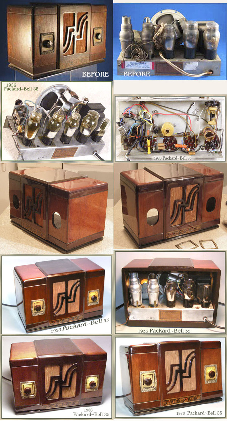

Burnt Fingers wrote:
How come you waited so long to claim youve done more than AA5's, I certainly cant remember you showing any? Just repainted plastic, etc AA5's. How about some chassis photos Peter?
I dont need any silly colors in your diatribes either, black is fine.
Ahh.. Carl Carl Carl...lol
I didn't think you were the type that throws stones like this...
So why is it? Why do you do that? ... tsk tsk.
I think that keeping things at a nice discussion level of theory and supporting documentation is much better.
Y''know Carl.. The major difference between you and me is that ...at least I am WILLING to and CAN support what I claim...
Why do you want to see my NON AA5 work? .. Don't you believe me?
Be careful what you ask for.. just a small sample of them may choke up your screen...
Obviously you don't follow the restoration threads here much to see any of these radios that have all been there as each was completed.
So here's just a few.. Mr. "doubting Thomas"
But ok here goes...
( BTW ...I expect YOU now, to show your schematics and supporting info now too ok?)...lol
Remember you asked! .... lol
Here's just the first TEN or so radios... how many more do you need to see, Carl?...lol
BTW.. Since I don't bother to re-stuff the old electrolytic can-caps, you'll see that I have (mostly) also used radial-lead electrolytic caps in all these radios ... but you'll find them all neatly placed.. and maybe even a little hard to find mounted vertically.

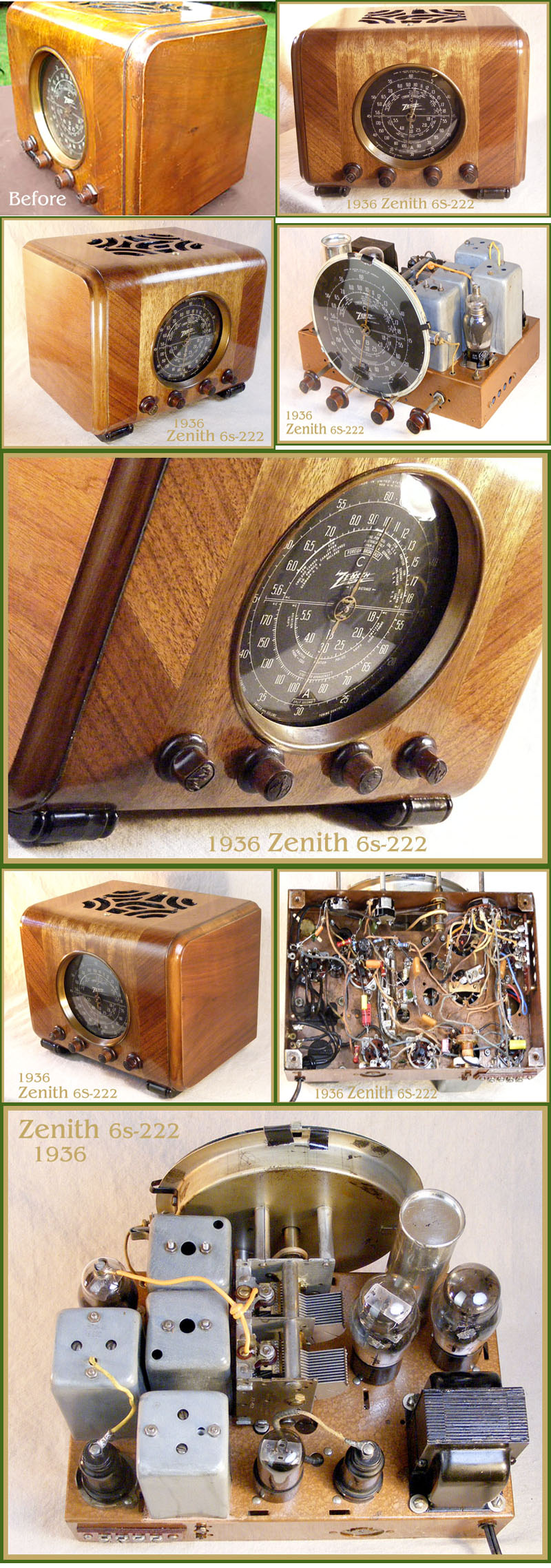

Hi Peter, That Zenith 6S222 is beautiful. I love those smaller wood radios. I recently picked up a small Rogers Radio that is beautiful also.
I restored a Marconi not to long ago. It was a standard BCB and SW listener in an floor model cabnet. Component placement in this old fella (early 40's) was picky. The unit had selector push buttons located above the chassis, at the end of long wires, three to be exact. When the pushbutton that tuned the upper most part of the dial was depressed, the radio would go silent. Removing the 6SA7 converter tube or turning the radio off then on again would make the radio work again. It only did this after it was warmed up. I originally thought the oscillator was stopping, so I went in there with a scope and to my suprise, the oscillator was still going. Now the weird part...Pin 8 the mixer grid was positive 150 Volts...Even with the 1Meg resistor on the grid tied to a bias cell. There were no oscillations on this pin, just DC. So I switched the radio off and on again, the DC 150 was gone and the grid was back to the negative Voltage it was supposed to be. The caps in this section were all changed, as well as all the resistors. So I tried another tube, same deal. Changed out the caps again, same deal. It turns out that the main tuning cap had to be up at the upper portion of the dial as well as the use of the "one "upper dial pushbutton for this action to happen. When the upper dial pushbutton gets released, there would be a strong parasitic oscillation for a brief moment on the mixer grid. It would charge the grid positive and the tube assisted in keeping it there. If I took a low value resistor say 20K or so, and grounded the mixer grid through it for a second, the radio would work again. This is a really weird problem! I found that if I installed a small Neon bulb on the mixer grid to ground, it would ionize when the pushbutton was released and drain the charge off the grid, thus the radio would function again. There are some coils close to my newly installed capacitors. The coil was coupling to the near by capacitor and creating this weird anomaly. When I moved the capacitor further away from the coil, the Neon bulb's ionization got weaker. You see, the original capacitor had the "outer foil ground" close to this coil. Since the outer foil sheilded the capacitor, this affect did not happen. Newer capacitors are built different and the circuit did not agree with the original component placement. So I relocated the ground of this capacitor and moved it away from the coil where the original capacitor was placed. The Neon did not ionize any more. The radio now has been working flawlessly. So capacitor component placement does matter even in the lower bands, (in some radios) anyways. This is why shotgunning capacitors for newbies is a bad idea. It takes some skill with test gear, and "know how" to solve a problem like this. A lot of us, including myself, forget and take this ability for granted. It just goes to remind me to be patient with the newbies to this hobby. Thats my story.
