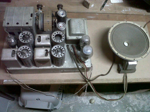

Again, I have been looking for an old cathedral style radio to do some work on. However I don't want to do anything drastic to a chasis until I know that it is not repairable.

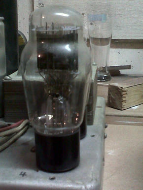

I have came across and purchased a model 2171 SuperHetrodyne Grimes Batteryless Phonola Radio. I have no idea if there is another popular name for that radio, but its what is transcribed on the working of the electronics. I am new at this obviously and appreciate any and all words of wisdom. The radio when powered has a very quiet hiss and all but one tube heats up or lights.
I took Phil's advice and looked at the tubes on the radio. (7 in total)
All Westinghouse RADIOTRON or RADIOTUBE:
[*]5 Prong Socket 35 (Thermionics Ltd)
[*]5 Prong Socket 24A (Thermionics Ltd) - two
[*]5 Prong Socket 235-A
[*]5 Prong Socket 27 c2R
[*]5 Prong Socket 47 2B (This tube has broken elements)
[*]4 Prong Socket 80
I have some images to share:
Image Image Image
This is the tube I need to replace...

Ledsoul, what you can do mean time is to pull the rectifier out of its socket and check with a volt meter from each plate to ground while plugged in and turned on. Should get some high voltage so set the meter "high" 300V plus on A/C. Each plate to ground should measure about the same. Then change to a lower voltage setting to measure the 5 Volts A/C for the filaments. This should indicate a good power transformer. Might leave it running with the rectifier tube out for some time and the transformer shouldn't get hot. Your get to go then when you get the tube AND replace the electrolytic caps in the power supply. See what you have and then slowly replace the wax caps and check the resistor values. Do a little bit of changing at a time and retest. If things get worse, back up and check your work. That is a very attractive radio and should find a nice place in your abode.

Well thanks to the 47 tube that Genoo (Gene) sent. Thank you sir. The radio tunes nicely.
The volume dial works with only a minor volume change.
However I am curious about the tone (assuming its tone) dial. It only works when I have it completely turned to the right. Slightly off and the sound is lost. Is it a possible dirty potentiometer?

Probably time to attack some of the capacitors if you have not yet. Certainly the electrolytics which won't fix your current problems but which may save the radio from other more costly repairs. Then the wax caps which will probably fix you current problems. Check resistors along the way. Just a few at a time to change out then test the radio again to seen if perhaps you didn't get something right. Have fun, a lot of joy in getting an old radio up and running again. Once right, you will be looking for another. Enjoy and ask questions.
