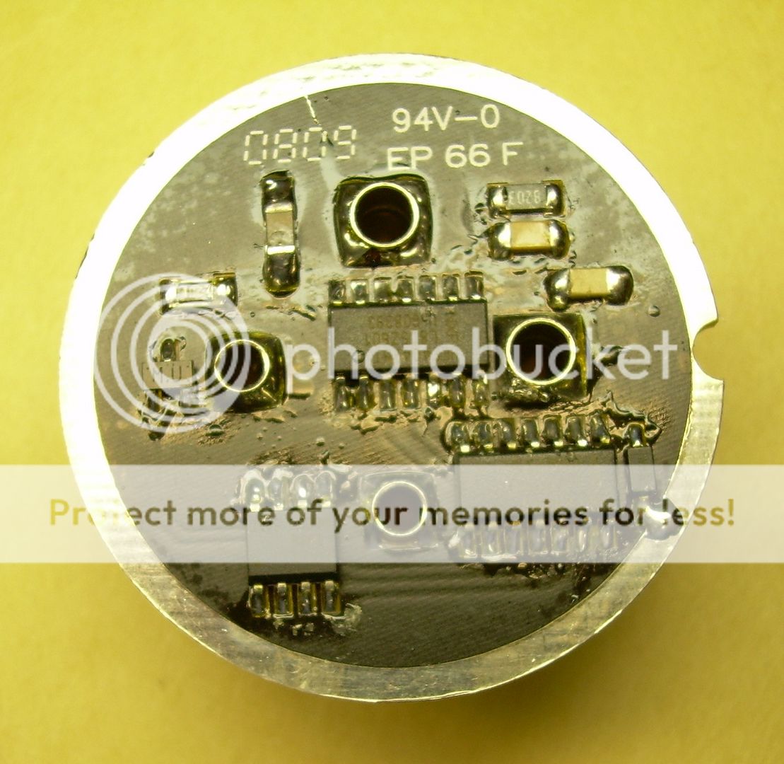

I have used several of the 1015 SS vibrators and had very good results, one I did about 8 yrs ago and still going strong. They dissipate almost no heat. Here is a pic of the inside
