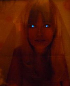

I use a couple of hi-intensity blue LEDS as a MIDI bus status monitor in my synth lab.
I used two ordinary green LEDs in series, connected straight across the MIDI signal bus, until the "superblues" came along and I installed a couple of those. They were actually too bright, so I had to wire a resistor in series with the LEDS.
Thus:
The monitor is mounted in a frame on the wall. This isn't a very good pic, but you get the general idea. When the bus is hot, the lights glow faintly; any signal flashes them brightly. With an involved sequencer program driving the bus, they stay bright.
:wink: Larry
