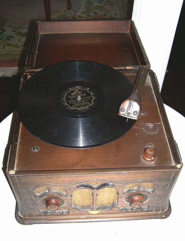

No, the gold is a lacquer, not the plating used pre-1928.
The phonograph business practically died in the Depression. Industry wide record sales were over a hundred million discs in 1929, down from almost a hundred-twenty million in 1927. Record sales in 1932 were but SIX MILLION units. Repeal pretty well saved the record industry, well, Repeal and the automatic phonograph.

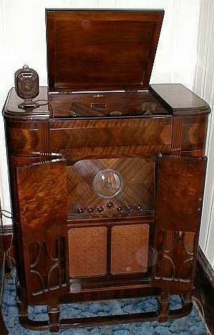

With the beginnings of recovery in the summer of 1934, RCA Victor management puled out the stops, and introduced their most comprehensive of combinations since 1928. ranging from the little 300 Duo, a four-tube AC radio and electric phonograph housed in an attractive cabinet which was smaller than most spring wound portables, retailing for but $39.95, less than the price of the previous season's 2-65 suitcase portable:
to the majestic 381Duo:
The knobs from a Radiola 80 or a Victor RE-57 work, though the might be a trifle long. The machine shared irs knobs with the 310, another scarce machine.
