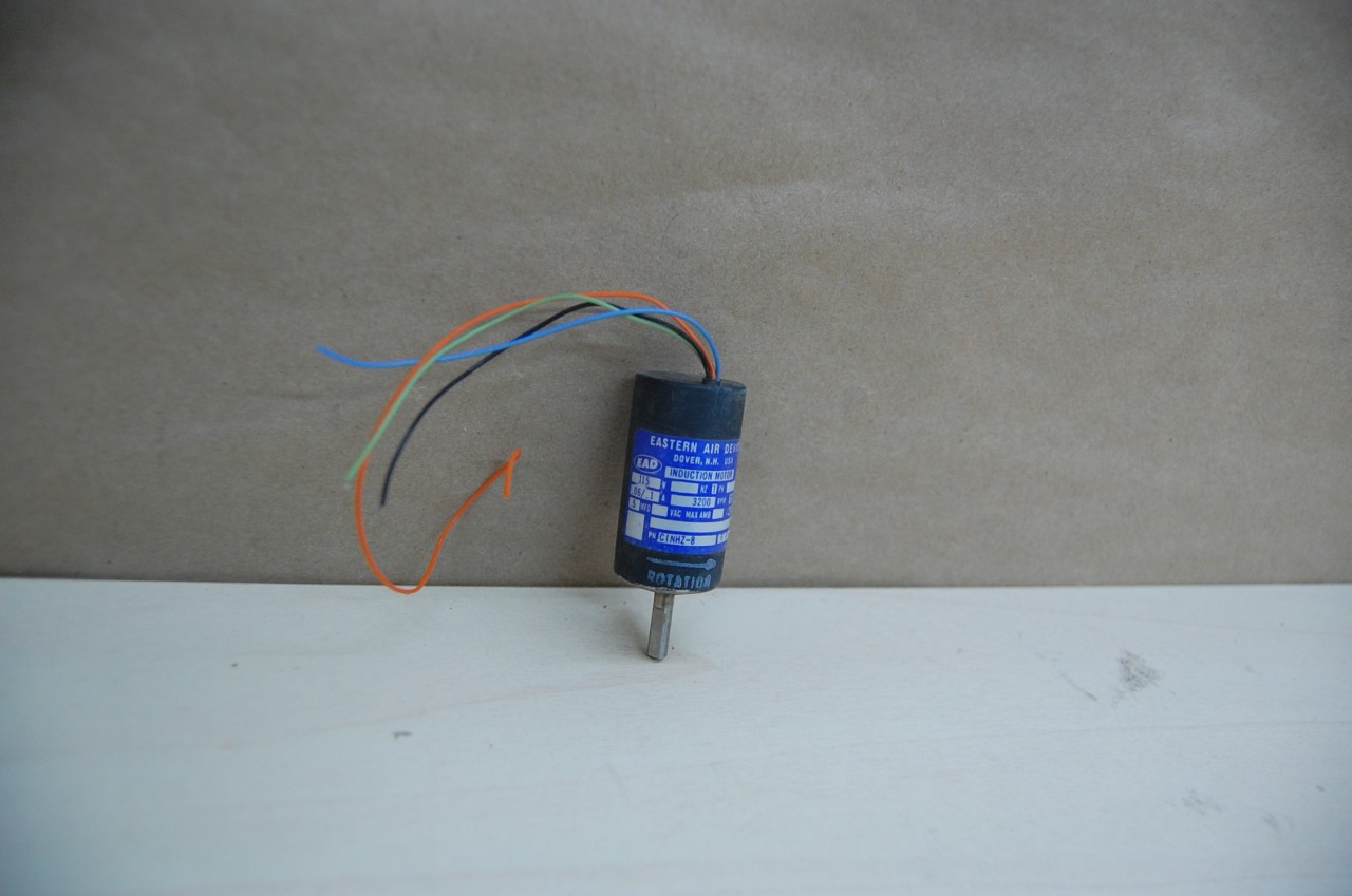

My 453 has an Eastern Air Devices fan motor. Armature is tight and the motor won't run so it will have to come apart. Anybody know how this one comes apart? Appears like it could be a sealed unit but there is a small cap on one end with a very small hole off to the side. I hope someone knows more than I do right now so I don't ruin it attempting to get it apart.
Thanks, Greg

I found a replacement Eastern Air Devices fan motor on eBay for $10 and just installed, fan is working FB now. Would still like to try to fix the old one for a spare.
Greg

I decided to update the info in case someone else also has an EAD (Eastern Air Devices) fan motor in their Tek scope which needs bearing service. I discovered the end caps simply pry off by inserting a suitable tool in the small hole in each cap. Once the caps have been removed you will find small snap-rings with shims which are removed in the usual way. The part number for the bearings is R3FF which denotes a sealed permanently lubricated bearing. Several on-line auction sellers are offering them for as little as $4 each plus shipping. Also available is the type R3ZZ which is a the same size and shielded (not sealed) bearing which will not only allow but require periodic lubrication.

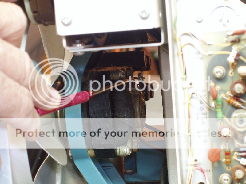

Posts: 3174
just for grins I thought I'd toss in this pic of the lube port for older 500 series fan motors. The lead dress tool has a 90* bend on the far end
which is resting in the oiling hole. There is another oiling hole on the "fan end" of the shaft as well. These older motors had a big thick Felt
washer at the location of the hole which acted as oil reservoirs. I think they were supposed to be filled every hundred hours of operation or once a year which
ever comes first.
ever comes first.
For the 500 type motor I believe you would use Non-Detergent SAE 15 Turbine Oil. Hammond Organ oil is of this composition. You could also probably purchase the 3-IN-1 Electric Motor Oil in the blue container with a picture of a electric motor on it. The 3-IN-1 Electric Motor Oil is Non-Detergent SAE20 oil.
Donald R. Resor
N6KAW
www.hammondorganservice.com
 Post subject: Re: Tek 453 fan motor lubrication
PostPosted: Jul Tue 10, 2012 11:43 am
Posts: 3174
Didn't know 3 in 1 made a "motor" oil. Regular 3 in 1 isn't much of an oil beyond just being handy.
