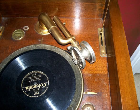

Well, some specialty sets were assembled by small makers beginning in 1922. I recall one rather large and elaborate machine which was offered by an Indiana maker who's name doesn't come immediately to mind, first assembled in late 1922 as 1923 models. Sonora offered combinations as early as 1923. RCA offered a set, the Radiola IX which was especially designed for installation in a talking machine, and was thin enough to install upside down inside the domed lid of a large machine. Brunswick offered a number of uprights fitted with the Radiola IX through their dealer network in late 1923 or early 1924. The customer response was so positive that Brunswick almost immediately concluded an agreement with RCA for the installation of Radiolas in the 1924 line of Brunswick phonographs. Brunswick subsequently offered a complete line of machines, ranging forma simple, plain console equipped with a Radiola III, up up to elaborate Art Case consoles fitted with the new Radiola Super-Hetrodyne.
Here are some photos of a typical Brunswick combination of that early period, a BR-60, fitted with an AR-312, the regular "Super-VIII" chassis on a specially arranged panel:

Beautiful-but appears to be acoustic player? I assume that it was much later that electrical pickups were made to allow electronic amplification of the records? So maybe we should narrow it down to the first unit with all electronic playback with the radio. I think that RCA pickup head in the Philco was not released until ca. 1929?
