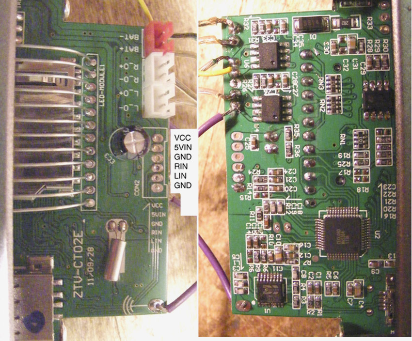

I also have a question about the signal labels on the Aux input pc board contact area.
There are 6 solder holes labeled:
1 = VCC
2 = 5V
3 = Gnd
4 = L-in
5 = R-in
6 = Gnd
I can put some audio from my other mp3-player headphone out jack ... into the L &R input and the last ground.
Then in AUX mode that audio sound clean.
What is the VCC and 5V points for?

Maybe I missed it but I can't tell how you're connecting it to the tube amp. You should be using the line outputs, shown here
http://f.io.ua/img_aa/medium/2031/32/20313297.jpg , and not the power amp.
 Post subject: Re: Intriguing MP3 module for AM transmitter (also FM)
PostPosted: Apr Mon 30, 2012 8:06 am
Posts: 9185
Hi Flipperhome:
On my unit those points that you are referring to in your photo above are marked as L-input and R-input
and when I change the mode to AUX.. and put a tone in on either of those two points I get that tone out on the header +/- output that I am now using for output.
Notice the whited printed text on the PC board just below that COM2 connector with the arrow pointing upward to that area.
So I'm taking the output from those white plastic headers marked L_O +/- and R_O +/-
I tried power in at the RED BATT +/- connector and also at the com2 connector points marked 5VIN and GND
and it seems to operate exactly the same with the prominent hiss sound in the background.

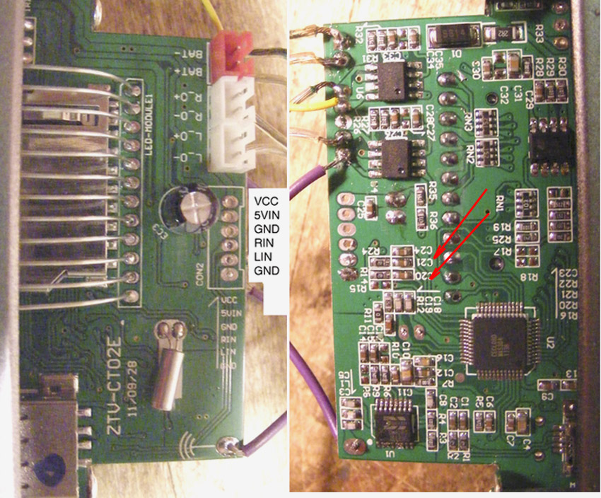

PostPosted: May Tue 01, 2012 12:10 am
Posts: 1396
Location: Saskatoon
Those points marked Lin and Rin are actually connected to the points where the MP3 decoder outputs are connected to the power amp inputs. So, you can use them for the line out. Your unit appears to be identical to mine, and that's the place I connected to, to get a line out.
I didn't get any noticeable hiss on my unit, but there is an extremely faint ticking noise in the background which is only audible between tracks when the volume is turned way up.

That's interesting. So The MP3 decoder feeds the 8002 PAs and that is the same point that an Aux input would feed the PAs.
OK ..I see.
Where is the volume control at though?
Can I still control vol if I take output from this point?
I'll try it later ... hope the hiss disappears.

Hi again Bob:
Not looking so good.
I do not have any audio at all on the points labeled L-in and R-in.
But if I poke around a little I can pick up a clean signal for each channel where chip U2 (the MP3 decoder?) connects into C20 & C21
(red arrows)
The headphones are connected between the point marked GND and each headphone channel to each cap
This does adjust by the vol control.. but it's tough trying to solder leads to that end of those two tiny SM caps...
I did do it but I'm sure it isn't proper because... it sounds pretty good in my headphones but when I plug it into my tube-amp... the input caps (maybe) in the tube amp must be no good for the signal at this spot or it loads it down too much ....because I hear that slow clicking ....which I can almost get rid of by increasing the vol real high.. but it just doesn't seem right.
Are you SURE your board is EXACTLY the same?
Any other ideas?

You're right. There appears to be a difference in the boards. I notice from your photo, the model number is ZTV-CT02E, and mine is ZTV-CT02B.
What may be simpler, is to connect the positive speaker outputs through a resistive attenuator to your tube amp input. Leave the negative speaker outputs unconnected, and use the regular ground as the common. You'll also have to put a DC blocking capacitor in series with the output, because the positive speaker output will have a DC bias on it.
That should give you more volume control range, and hopefully reduce the amount of hiss.

LIN and RIN are inputs, not outputs so you would not detect any signal there. Curious as to why you're soldering wires directly to the board, did it not come with pigtails?
