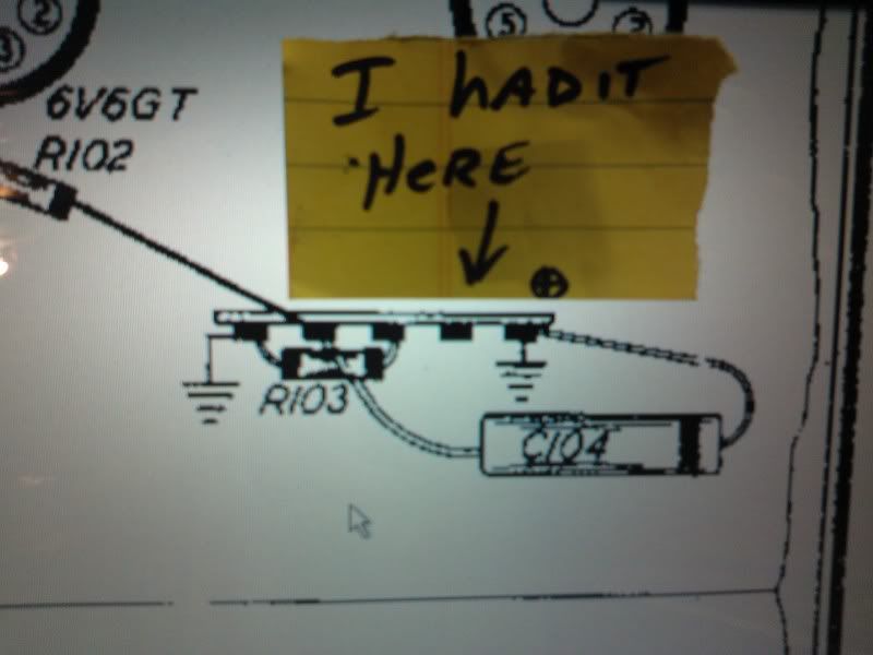

Yes I have replaced the tube. I'll try grounding the pins with a cap. You said 1 uf should u touch the negative side to the chassis and I removed the 6s tube and I loose the hum too I didn't find any corrosion I loose reception too I'm working in that area and replacing anything I think could leak there are several mica caps in that area too I have on order in case one is leaking
OK, pulling the 6SQ7 stops the hum, so the problem is there, not in the 7AF7.
I bet if you ground the input grid, pin 2 of the 6SQ7 you will still have hum. It is a nice clean 60 Hz hum, not a power supply buzz, so I still think it is from pin 3 and pin 8 sharing a connection to the chassis. 60 Hz heater current is going from 6SQ7 pin 8 to ground, and if there is any resistance in that connection, it will feed a slight voltage into pin 3, the cathode, and the 6SQ7 will amplify it. If they are sharing a ground connection, cut the wire going to pin 8 and run a wire from Pin 8 to a different ground point, possibly pin 7 of one of the 6V6 tubes if that is near by. Or attach another ground lug to the chassis with a pop rivet or bolt, and run the pin 8 wire to it. In addition, see if you can improve the ground connection for pin 3, with solder to the chassis (difficult) or a bolt and star washer etc.

well hope nodody will kill me but I got rid of the hum completely . capacitor c 104 a .5uf cap that comes from the rectifier . I was determined to find the problem so I got the schematic blown up and a real nice one someone here gave me . I started to check voltages everywhere it showed it. I didnt get very far the first place I went to look I noticed that one end of c 104 wasnt to a ground. So I looked at the schematic for a half hour to make sure I screwed it up I had soldered the connection one tab over to the left on the drawing by accident . I changed it and eureka its perfect now . Thank you everybody for all your help, without the help I wouldn't have been so determined to fix it . Now I can try to get FM working . AM and SW work great I'll keep you all informed

That makes sense. I noticed earlier that .5 MFD capacitor filters the bias for the 6SQ7, which is unusual since that tube usually uses a grid leak or cathode bias. I didn't mention to check it as you said you changed all the capacitors, while that should have been the clue!
