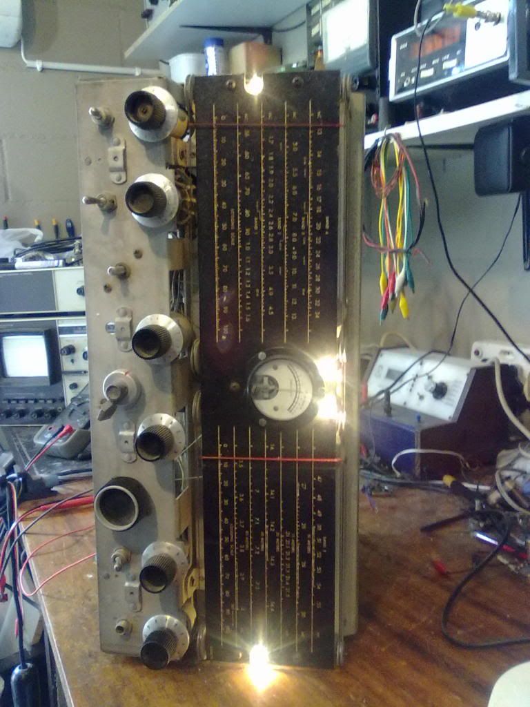

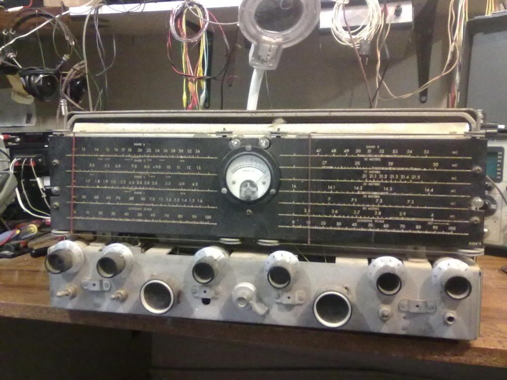

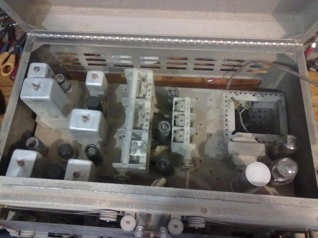

I received this sx71 is this condition BUT will it be worth it ? :shock:
Will have to hunt for front panel ... :roll: wonder if someone out their could put me in the right direction ?
Looks like all the knobs is on . Will have to install mains transformer - I think somewhere i might have sx42 mains transformer ...will check voltages
Your thoughts please
Dirk

Your SX-71 is a later production version because the 15 meter band appears on the band spread side of the dial.
The SX-71 is a competent receiver and their first double conversion design with a 455 Khz. second IF. The S-76 came out a short time later and was also double conversion but was the first of the Hallicrafters to use a 50 Khz. final IF and that became the Hallicrafters standard with the SX-88, 96, 100, 101, 115 and 117 receivers. The SX-71 relies upon a crystal filter for most of its selectivity capability while the later receivers benefited from the very nice selectivity from the low final IF.
The SX-71 is a decent general coverage receiver and is usable for amateur radio operation. Since you need a front panel you are probably looking for a parts unit in good shape and it is likely the parts unit may be cleaner than what you have now. If the parts unit is an earlier run, you might want to transfer your dial scale over to it.
Whether it is worth repairing will have to be decided in terms of how much fun you have restoring gear. The SX-71 was sold in large numbers and it was a decent receiver but nothing extra special. It was the first of the Hallicrafters dual conversion receivers and few of the double conversion Hallicrafters used a 455 Khz. final IF; the SX-73 comes to mind and there may have a few other models but Halli settled on using a very low frequency final IF. It will also receive NBFM which was marketed heavily by Hallicrafters as a means for amateurs to avoid BCI (broadcast interference) but TVI quickly made BCI relatively less important and NBFM for HF use never caught on. I have a HT-18 VFO and HT-19 transmitter, both with built in NBFM , but those were short run items, I don't think the HT-19 really made it into full production. My HT-19 came with the original 4 pages of instructions and open binding posts on the back which are hot with 1,500 volts; these posts allowed the use of an external modulator for AM but there should have been a cover on them.

It looks like the power transformer is missing. That will add the to the cost of restoration unless you can pick up a junker SX-71 to obtain the front panel and cabinet that also has a good power transformer.

The same fellow I bought my SX-71 from and to whom I gave a small stack of 30s QSTs (duplicates) saw me at the next hamfest and passed a faceless parts-donor SX-71 to me insisting I take it. I insisted on some minor remuneration back to him. The following hamfest, he brought this SX-71 face.
Don't know what the shipping to U of SA will be but I doubt the panel will be damaged in shipping. It's a tough piece of metal. Sorry, transformer needed here but then I believe you need a 50 Hz 240 volter anyway.
It is a Run 4, the final production and it was and looks like 15M was a jammed in afterthought. Since 15M was approved years before actually being released Halli could have designed the radio with it at the begining and provided a full width bandspread.
Its a worthwhie receiver to restore just for the high image rejection of the double conversion which will be a big help for the frequencies above about 12-14 MHz.
Just dont expect much on 6M.

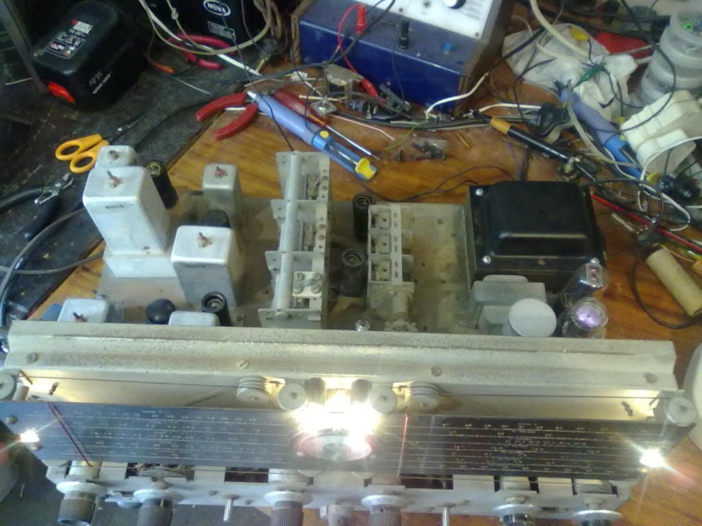

After replacing power supply transformer and electrolytics :D switched on and heard stations all over ..
Some valves was changed before - 6SK7 with miniture valve and 6SC7 with 6SN7
The cabinet has seen beter days , will soon start on respray project ..

I too have an SX-71 that I'm rehabbing, a late model I believe. Check my thread on it. I have recapped and
replaced out of spec. resistors. I can't figure why the S meter won't work. Meter seems fine. A resistor
(can't remember of hand which one) keeps burning up.
Have you done anything more than cleaning to that front panel. Mine looked rough like yours and I did not
to go through the bother of sanding, repainting and trying to re-letter it. Silk screening is very expensive
so that was out of the question.
So I cleaned it very carefully soaked it in a solution of warm water and plain dawn dish detergent. Rubbed
it gently with a soft cloth and rinsed it well. Let it dry overnight and do the same again. Let it dry for 24
hours and make sure there is no lint.
I then applied about 5 coats of Krylon satin clear coat (TEST FIRST ON A VERY SMALL AREA). What that did
make slight scratches almost disappear and larger ones lessen. Plus it gave it a "fresher" look. I clear coat
should also help protect the lettering.
