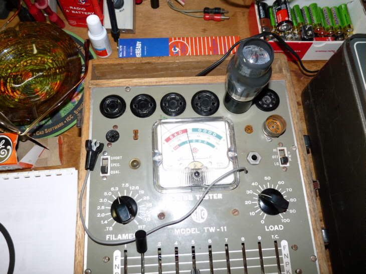

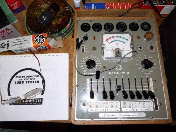

This is a Superior Instruments (SICO) model TW-11 tester from about 1957, simple and straightforward to set up and use. It will test for shorts, leakage, and even microphonics, with a magnetic headphone plugged into the service jack. It may or may not catch grid emission (that would show up as leakage), but it is still adequate for most jobs that don't require precision testing. Since it may be set up and used quickly, it's the ideal thing for vetting that boxload of new arrivals from the fest.
This "bad-?-good" scale is typical of emission testers. Note that there is a supplementary "B" scale, meant for low-drain tubes (mostly detector diodes and battery tubes). Quality is read on a scale of 100% as ideal, although in practice, very few tubes will ever approach that 100% reading.

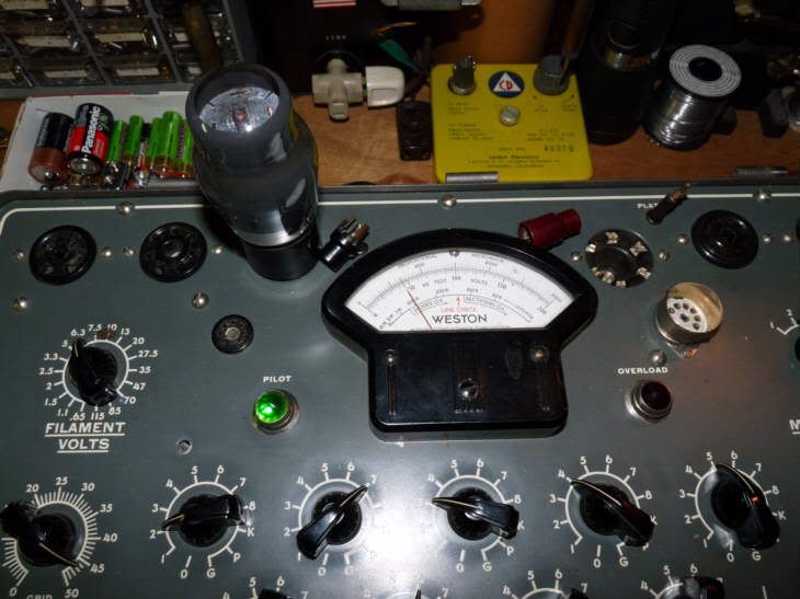

This is a Weston 981 dynamic MC tester from 1954. You can instantly see that this tester requires more "setup" than the little SICO emission tester pictured above. It will check for leakage as well as shorts. It gets its test signal from a type 3A4 oscillator. Like the SICO, it is too old for Compactrons, Novars or Nuvistors, but both testers will handle subminiatures. The Weston will also handle acorn tubes.
Notice that on this Weston and the SICO as well, the 9-pin test socket has been replaced. If you do a high volume of testing, then get in the habit of using a "socket saver" adapter with your testers, especially with the miniature sockets, which tend to wear out IN A HURRY :shock: !
The meter is scaled in micromhos, the unit of transconductance. Again, diodes/rectifiers have their own reading scale (since they receive a different kind of test, being incapable of amplification). VR tubes also have their own scale, measured in volts.

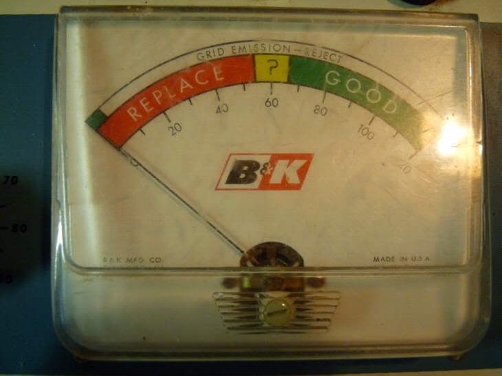

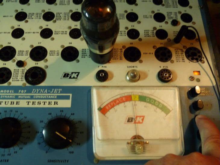

This is a B&K 707 "Dynajet" hybrid tester from 1965. This tester was meant for the service shop bench and is very easily set up, compared to the Weston. It has an upper rank of "preset" sockets covering the types most likely to be encountered on the bench. These get transconductance tests. A lower rank of sockets and controls deal with other, less frequently encountered tubes, which get only emissions tests. Although it has no sockets for the old 4-5-6-7-pin tubes, it will handle Novars, Compactrons and Nuvistors.
This tester, being a hybrid, uses the "bad-?-good" meter of straight emission testers, and doesn't give you any actual transconductance measurements. It does, however, have a grid emission scale.

First the SICO, with a reading just over the threshold of "bad:"
Then the Weston 981, showing a reading of roughly 620 against a designated rejection point of 830. With an instruction for "X2" reading, this translates out to an actual reading of 1240 micromhos (against the tester's specified rejection point of 1660). Against a designated (tube manual) new-tube value of 2500 to 2550 (depending on circuit), this reading translates to just under 50% of specified new-tube capacity.
And now the B&K Dynajet, showing a reading roughly equivalent to that of the SICO.

The B&K 707 only checks Gm on the pre-wired sockets. The switched sockets get an emission test.
