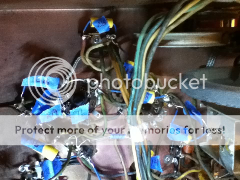

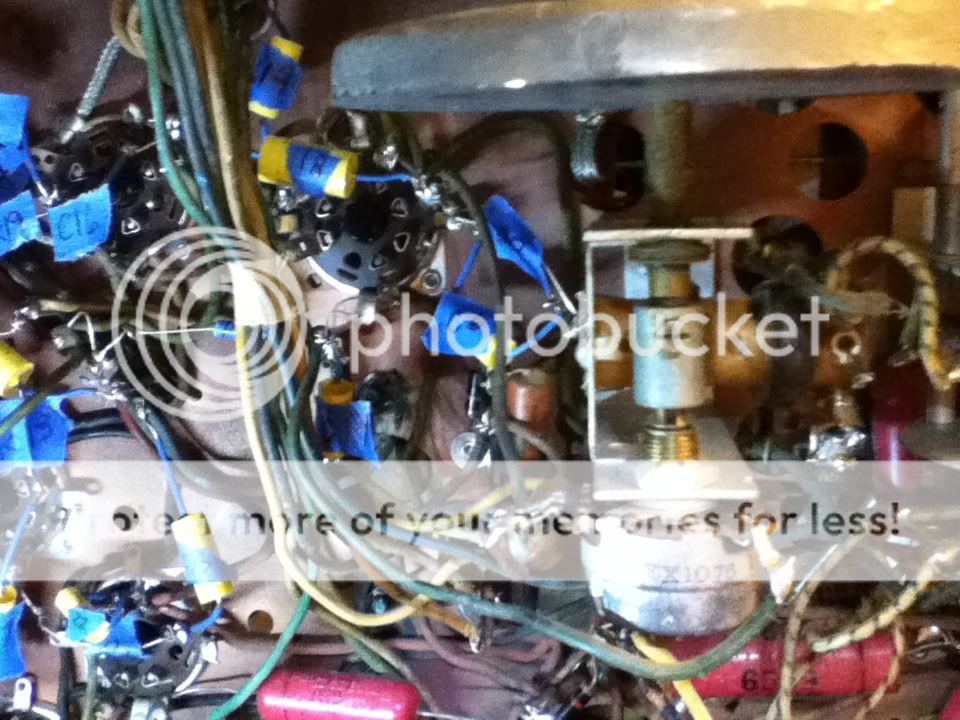

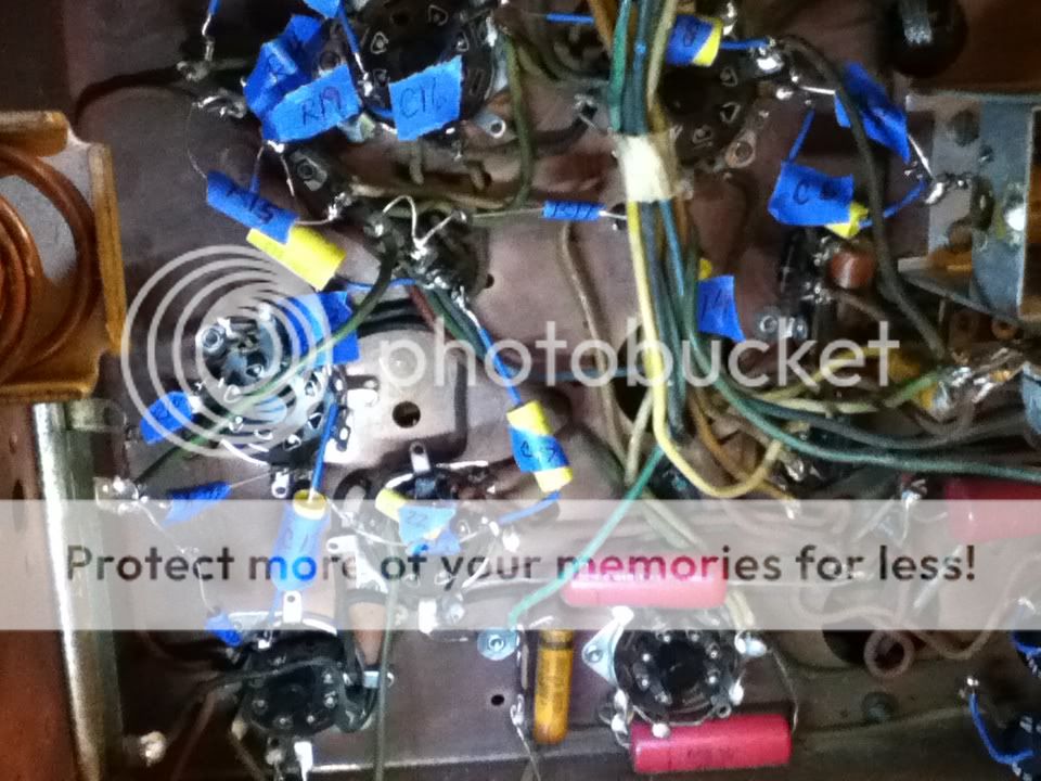

Ok, here are some pictures. Not the best quality, as I was using my ipod. I can take better pictures once my camera is charged, if need be. Please be gentle with your critiques, please. I will listen to all advice. This is my first attempt at doing anything remotely like this ...
I labeled each part as I believe it to be.
This is the side I've been working on, overall view. The radio worked beautifully when I had replaced all of what is tagged with blue tape on the left hand side, from the top of the photo down.
The radio ceased to work when the items on the top and right side.
Another view of the trouble area.
Thanks!
Nicole
 Post subject: Re: chassis removed ... now what?
PostPosted: May Wed 02, 2012 12:10 pm
Posts: 7873
I still see some paper capacitors (the reddish and goldish cylindrical components) in the radio and unless you have already replaced them do so before any further troubleshooting. It could be that one of those parts failed causing your radio to stop working.
