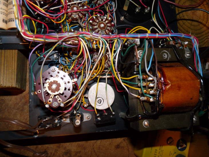

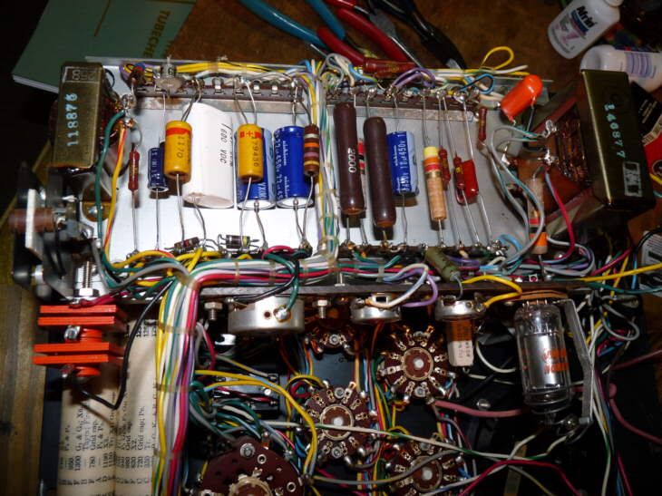

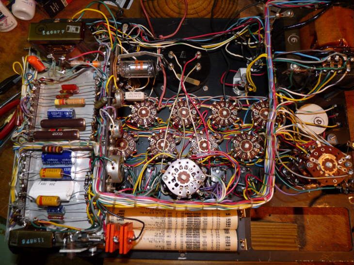

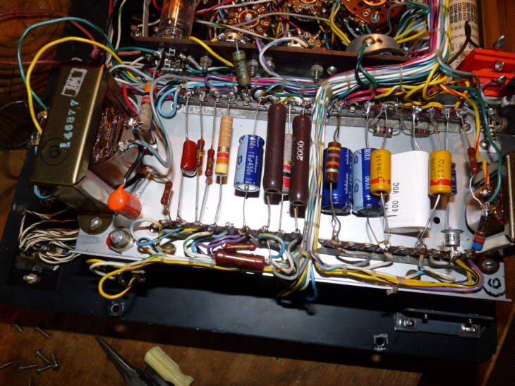

 Post subject: Re: Tube Tester Lore for the Novice
PostPosted: May Thu 17, 2012 12:47 am
Posts: 6032
Location: Raleigh NC USA
Inside the Weston 981 (Series 3, first edition). It might have been laid out with a service tech in mind.
I haven't done a thing to "tidy things up" here. It came from the factory as immaculate as you see it now. What kind of assembly job must it have been, with all those connections to all those sockets, terminals and switches!
The roll chart is the 1954 original. I later picked up a 1960 roll chart laid out as sheets in a booklet, along with a booklet of "obsolete" tube test settings that didn't make the original roll chart. The paper of the roll chart feels waxy to the touch (and looks a little "waxy" in the pictures).
All the caps are mounted in this terminal block where they can easily be reached. The entire job of recapping took no more than half an hour. All the original resistors in the terminal block are still present. Small transformers are mounted to either end of the block. The calibration adjustment pots are mounted on top of the block, and so is the 3A4 signal oscillator tube.
There are several silicon and selenium rectifiers in this tester. The two yellow cylindrical objects with red stripes are small selenium rectifiers. As with the two small "standard" seleniums off to the left, I chose to leave these alone. I've never been fond of the things, and I tend to update them when I consider it wise, but since these are performing up to standard, I prefer to keep them in place.
This picture gives a good view of the three calibration pots and the 3A4 tube. It doesn't look like it's completely into its socket, but it is.
The earliest 981 Series 3 tester had an overload lamp (#47 bulb paralleled with a 6.5-ohm resistor). The light glows faintly when almost any tube is under test, and glows more strongly with tubes that draw more plate current. The parallel resistor (a sandbox-style power resistor) is visible under the right-hand calibration pot. The lamp fixture is hidden beneath it.
The overload lamp was done away with in later refinements of this tester.
A view of the tester's power transformer. A few small resistors spill off it onto test socket row, but since they measured up to specs (like those on the terminal block), I let them be.
Like the two small transformers on the terminal block, this transformer appears to have been "doped" (weatherproofed?). All three transformers look as they came straight out of the box.
By comparison, the little SICO emission tester's interior is very simple, only a handful of resistors and one small cap. No rectifiers, operates purely on AC. There are no calibration adjustments either; the only way to keep this tester "honest" is to keep its fixed resistors dead on the mark.
Two more projects crossed off the list, but now it's on to worse ones...
:wink: Larry
