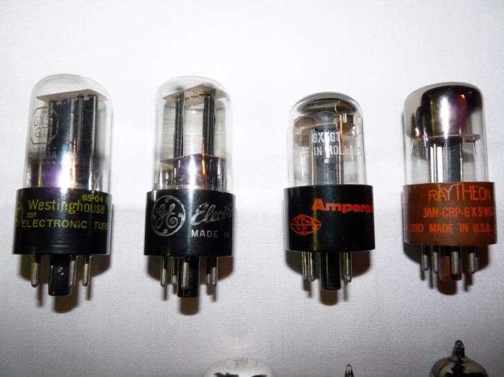

Several styles of 6X5GT are shown here. They vary in plate and cathode arrangement. The tube on the left displays "offset" plates surrounding a single cathode sleeve. The next tube rightward shows two independent plate-cathode structures. The third tube rightward (the most modern) shows a figure-X plate arrangement with a single cathode sleeve. The tube on the right, a 6X5WGT, shows a ruggedized figure-X plate arrangement. I do not currently have a 6X5GT having a "stacked" plate arrangement such as the 6X5G and its forerunner, the 84/6Z4, commonly had.

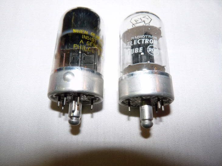

Two 7Y4 tubes. The older one on the left has the stacked-plate arrangement, and the one on the right (which has lost its vacuum and getter) has the figure-X plate arrangement, which the 6X4 miniature equivalent of the 6X5 seems to have pioneered. As shown above, 7Y4 and 6X5 tubes both migrated to this arrangement over time.

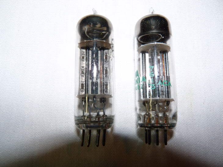

Later came the 6BW4, a 9-pin miniature with a pair of plate and cathode structures, and the 6CA4, another 9-pin miniature, with a figure-X plate structure. It is the toughest of the lot and is often found in hi-fi components.
7Z4 to left, 6BW4 in middle, 6CA4 to the right.
