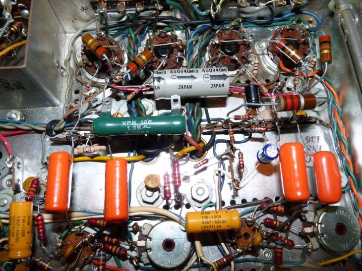

OK, here it is. They fed the screens with a single wire straight across pins 4 and 8, serving all four tubes in a line. I clipped the midsections and tied the safeties to the closest pins. With the two on the right, it looks like pin 8; on the others, pin 4. However, as you can see, the voltage still goes to both pins on all four tubes.
You can also see the replacement control grid resistors (270K) and the cathode safeties (12 ohms) in this photo. The bias supply is out of view to the left.
Hope this helps. By the way, does your Fisher forum over at AK have the schematics Wilbur wants? I have nothing on the 500.

I was thinking 500C. The 375v is to pin 8.
I just pulled an 800C schematic, and the 375v screen voltage goes to pin "4/8", so I assume they're tied internally and either pin will work. If you have a chance to check that would be great.
Another edit...I assume 1/2 watters would be fine?
For screen safeties at 200 or 220 ohms, they should be. Those one-watters in my 800 get somewhat warm over time, but not very. The half-watter would also have the advantage of blowing faster, if there was a screen short.
