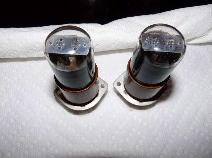

 Post subject: Re: Tube "Leakage" Question
PostPosted: May Fri 25, 2012 3:42 pm
Posts: 6032
Location: Raleigh NC USA
It's vaporization of the cathode coating, deposited on the micas and making leakage paths between elements. It's worst with output tubes, for they run the hottest, but small-signal tubes are subject to it also. It's worse with all tubes when their heaters are overvolted.
The tube on the right (a 6SU7GTY) fouled out with leakage that injected a loud "sputtery-spit" noise into the signal path. Compare its top mica with its twin on the left (NOS).
Tomer explains the entire matter in Getting the Most out of Vacuum Tubes (Gernsback, available online).
