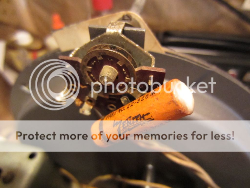

I'm just going to go ahead and replace the candohm sections. I really want this set to be "perky". First I will do the lytics and power it up. Anyway, I'm still waiting for parts from Justradios. I still need 3 Zenith etched tubes, Bueller, Bueller..... :lol: . I got the dropping resistor today. THANK YOU SO MUCH PETER!!!!! I also got the dial belt as well.
While I'm waiting for parts, I'd like to replace the string in place of the dial belt. I did some reading and I see a lot of guys cut an O ring and glue it back together for easy installation. I bought the a belt from Adam so I'm going to give it a go. Here's a picture of what's going on. I have no clue what is going on here. Do I have to remove the dial and pointer :shock:?
How exactly do I go about installing this new belt?

Holes are for the spring that puts tension on the tensioner pulley. Loosen the pulleys at the front of the radio (and anything else attached to the tuning shaft) and slide the shaft forward. Then you can loop the belt over the end of the shaft.
 Post subject: Re: Zenith 6-S-254 Restoration -- Dial Belt Installation
PostPosted: May Wed 30, 2012 1:25 am
Posts: 13165
Location: Berkeley, CA 94709
Not familiar with this model, but pointers should pull off. Probably have to remove dial pan to get belt around top pulley.

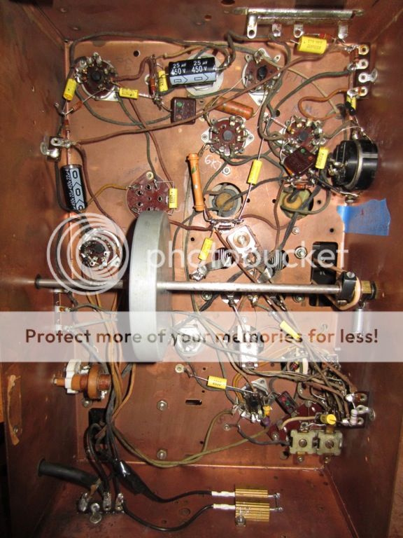

Okay, I spent a whole day wiring in the lytics, nice and neat under the chassis. Then I replaced the 6F6 output tube capacitor as per Pred (Should I do this for all radios, why is this a good idea). I also replaced one resistor that was on the same terminal as one of the lytics.
Then pulled all the tubes, sprayed the pins with CRC contact cleaner. I rubbed each pin with a scotch brite pad, then gave each one another spray with the CRC. Then I sprayed the sockets, and plugged and unplugged each tube a few times to clean the sockets.
Then I cleaned all of the grid caps and wires thoroughly.
I sprayed the volume pot, tone control, and band switch as well.
Now it's time to put the dial back together. For bulb diffusers I cut a roughly 2" by 3/4" rectangle out of a plastic milk jug. I made two, and slid them in front of the bulbs. Then I put the dial scale on, and the gasket, and the glass. Let me just say, what a PITA :shock:, especially doing it by yourself. One slip of that glass and it's over...........
Get this, at about this time, it's 11pm. I get the dial all hooked up, and then I look to the side, the needles were still sitting on the bench......................................... :twisted: :twisted:. I'll never do that again. I became more skilled at reinstalling the dial assembly, so the second time around wasn't too bad, thank god.
I cleaned the antenna terminals, as well as the jumper and sprayed them with CRC.
I hooked up a 15" wire to the A terminal, with the G and Z terminal shorted together.
I went through the dim bulb test with rectifier removed, all tested good, put it back in and hooked up the DBT again, tested good. Plugged the radio straight into an outlet, turned it on, and it came to life. It wasn't playing through the dim bulb tester, I guess it was eating too much voltage.
For my first few trials I forgot to have the speaker plugged in (at this point I was delirious). It wasn't on for long, maybe a minute or two, not even, I hope I didn't fry anything. But I turned my transmitter on and it plays beautifully.
The sound is incredible, puts my other projects to shame. I'm ecstatic. My Dad and I built a speaker stand because it was causing distortion lying around on the bench before, when the radio is not in use I have a cardboard flap covering the cone for protection.
I replaced two more caps tonight, and I powered it up, again, I'm blown away, It's getting better!!! Shortwave is amazing, there's a loud and clear station every 1/8 of an inch on the dial.. Oldies in BASS mode sound warm, rich, phenomenal. I listened to it fot about 10-12 minutes tonight, I know I probably shouldn't with some old caps and resistors still in there, but I could not resist :D.
As far as resistors, I want to replace as many as I can, especially if they're on a terminal with a cap, but I replaced one, and came across another that read right on 1K ohms, which it should be, in circuit. I attached a heat sink and left it in place. I can always replace it, I hope it doesn't compromise performance. But like I said, it can always be replaced later if need be. I will replace the ones that are out of tolerance though, checking as I go................Correct me if I'm wrong, but if it reads under value, unhook one side, if it reads over, but within tolerance, leave it.
That's all for now. I will continue recapping as I find time. Stay tuned.

Just about done with the recap. This one went unusually simple, except for a few pieces that were buried. I have one more paper cap to go.
There are only a handful of resistors and mica caps in there, so they're all gone. I'm still looking for (2) 500pF 630V caps, a 25pF 630V cap, a 33K 1W resistor, and a 390K 1/2W resistor.
I accidentally purchased polystyrene type caps. I know they're supposedly better, but they are a bit too delicate and my main issue is that for some reason the leads won't reach from terminal to terminal. Besides, I have one of those "black drop" radial type from justradios so I'd like my pF caps to match. That's just me.
Anyway, as many of you may know I had an issue with less volume after a semi recap/re-resistor near the volume pot. Turns out I had a 1K resistor in place of a 1Meg resistor :shock:
Needless to say I put the right one in and now at level 4 of 15, it rattles the windows! Amazing how something like that can have such an effect. I'm glad I caught it before I continued on!
I restuffed the paper cap on the tone control because it can be seen above the chassis. I enjoyed the restuffing process, and I'm thinking I will do that for my next radio. It wasn't all that difficult and it sure does look nice.
Coming along very well. It doesn't pick up much BCB but then again, what's new for around here? My SSTRAN and this radio are a great match. Once the recap/re-resistor is done, I will preform a complete alignment and it should be ready to go back into the cabinet.
P.S. I really would like to replace the candohm just in case in opens for some reason. I want this radio to go another 70+ years. I'm going to need a terminal strip, I'm not sure where to get one. Also, I purchased 5W resistors. I went from 27ohm to 30ohm, but my big question for the day is for the 125ohm one, do I use a 120 or a 150? I purchased both, just in case.
