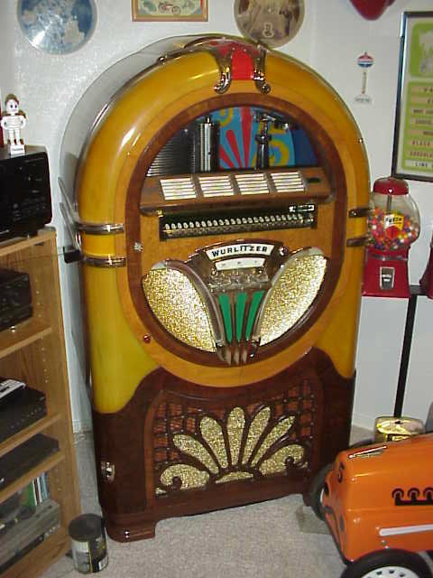

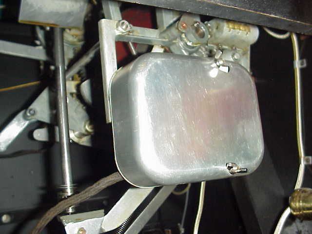

 Post subject: Re: How to convert Wurlitzer to free play?
PostPosted: Jun Thu 07, 2012 12:17 pm
Joined: Sep Sat 05, 2009 9:45 pm
Posts: 485
Location: Sun City, Arizona
Hi,
I restored my 750's some years ago so I just don't remember exactly how I put them on freeplay. I remember studying the manual and making a change in the accumulator. The ratchet wheels add/subtract credit so I think I added credit to the wheel and then defeated the removal of credit. I will assume yours is a 750-E and not a 750-M. Pictures show the green credit window in a 750-E title board. The M model did not have credit window that because as soon as a coin was deposited the mechanism went looking for the selection. Anyway pics show the areas in the manual to take a look at. Different versions of the manuals will likely have different pages. These things are just a hobby and I have a lousy memory. I'll try to spend some time figuring out what I did for freeplay.
First Pic – This is the part of manual to study
Second Pic – accumulator in manual
Third Pic – 750-E (not M) jukebox
Fourth Pic – 750-E Title Board With Green Credit Window. Lights if credit available (if it is working)
Fifth Pic – Accumulator
Sixth Pic- 750 -E Elec. Selector (leave alone if selecting properly)
Seventh Pic - Accumulator
