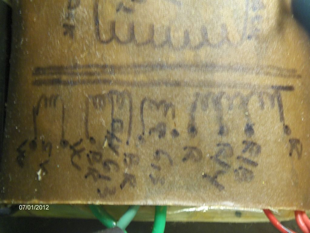

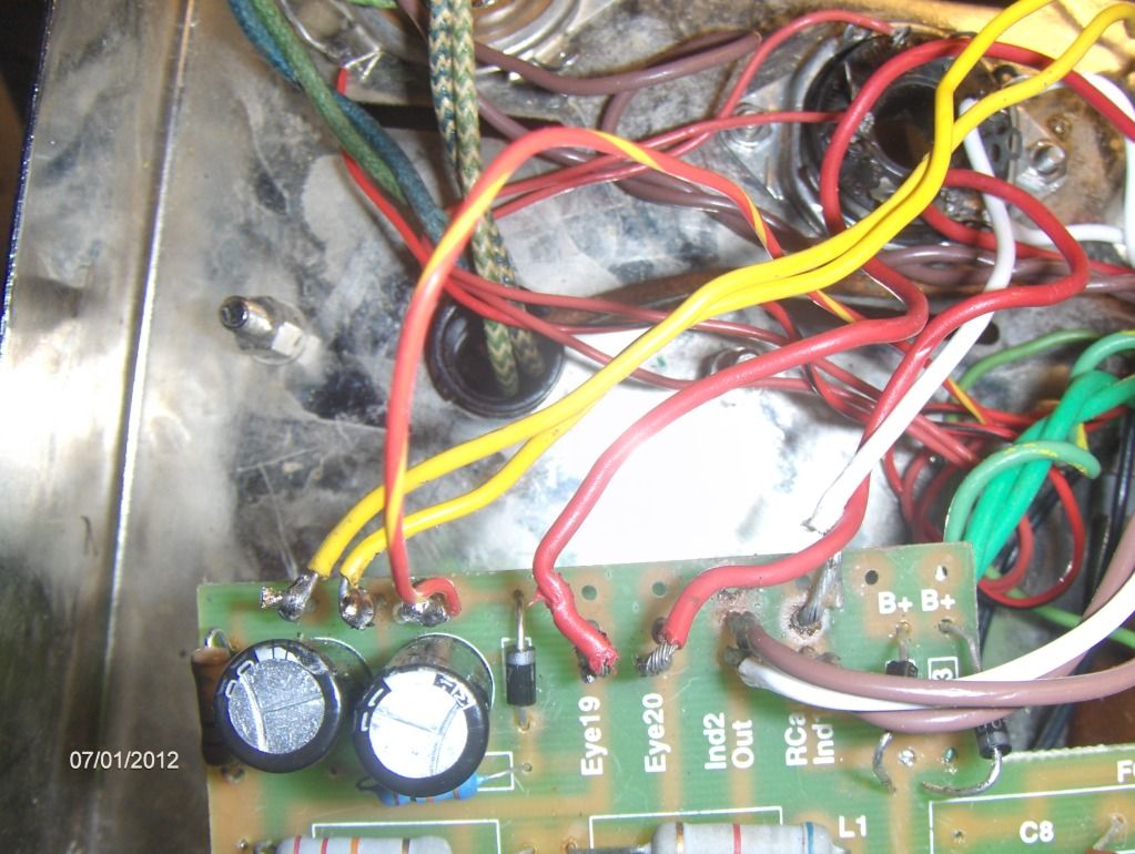

Someone put a cap replacement board in the amp and I am not sure one wire in in the correct spot.
On the picture the red with yellow tracer is the wire I am not sure about. The others I have traced back to their spots on the power board. This red/yellow wire comes form the main transformer and the connection on the cap board reads C- and the schematic calls it the Transformer Bias Winding. The is also a photo of the transformer with the schematic on it. This amp has not worked since I bought it, all the tubes test good, I have replaced all the caps. I can trace the sound from in put to output on the amp, but output is really garbled and not as clear as the input. It has K 77 and 7199 tubes in it. I tried to upload the photos by the directions on the forum but all I could get was a little red box. So pics are at link below,,sorry
http://s276.photobucket.com/albums/kk15/oakdust/ST-70/

Well you will have to find out who made the replacement circuit card before you can find out whats wrong
The transformers not stock either , looks like you have quite a mess on your hands

You got yourself a SDS labs cap board in there.Just do a google search
for SDS labs to get the info on the board wiring instructions.They are sold
by Triode Electronics.The power transformer you have in there is also from
Triode Electronics and is a heavy duty upgrade replacement for the marginal
rated stock Dynaco transformer.It has a taller lamination stack than the
stock Dynaco transformer and runs alot cooler.You can get the specs and
wiring info from Triode Electronics.You got a good deal there,two of the
big problem areas of that amp have already been addressed with those
new upgraded parts.I found the link for SDS labs:

Whoever did that soldering should be sternly disciplined. Reminds me of me when I was 8yo and never done it before.

That's a very good power supply and that board is a good way to take advantage of
modern capacitors and resistors. The bias supply is a bit tricky to get right on target,
so measure the voltage carefully. There are two pots (one for right channel and one for
left channel) that should be adjusted so that you don't run your output tubes "too hot".
Check the two potentiometers in the bias supply and make certain
they are in good working order.

The soldering and wire connections on that cap board
are atrocious.It's obvious it looks so bad I did not think
I had to initially comment on it.For all we know that could
be the cause of most of the problems.I can't imagine
what the underside of that board looks like.When
that amp gets all fixed up it will sound real good.

I agree, that may well be true. After verifying the wiring, I'd resolder that entire board, if it were my amp.

Well I found out the red/yellow wire is a ground wire and the red/black is the bias. Switched them, cleaned up some connections and now I have sound from the right but not the left. On werd and up werd

Found a bad solder joint on pin 7 of one of the K-77 tubes. Problem solved
