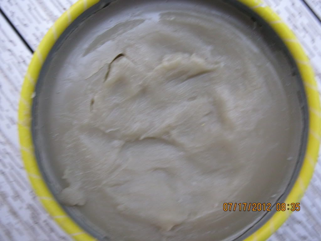

Ok Guys, I took a picture of the can of Johnson Paste Wax. Its a grey, green looking and the smell is so over whelming I had to take it outside when I tried to use it the first time! Let me know what you all think...Bad? Just not what I expected!!! Sorry about the oversize picture I am still trying to figure posting pictures out!! :oops:

Looks normal to me.
Bear in mind there's enough in that can for hundreds of console radios. You only need enough to wet the surface; any more will be buffed off and wasted.

It looks right to me as well. As for the smell, maybe I'm just around solvents too much to be bothered by it.
