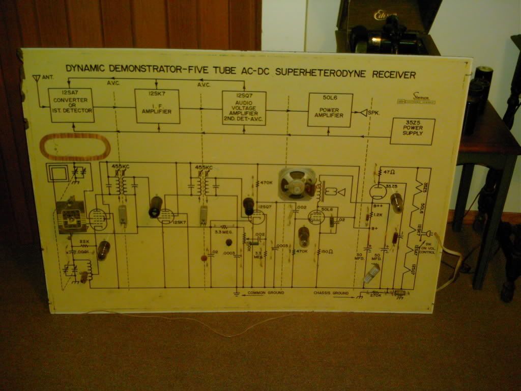

When working on a AA5 I still refer to this when I am stumped.
Wow! That is very cool, I bet there were many of those made for training back in the day. Probably not too many left.
Russ
