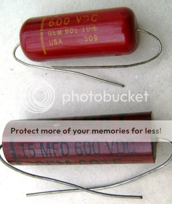

I always replace the wax caps without measurement but I found these in a Philco 37-610 which had been serviced some time ago. I measured every Mallory in the set and the insulation resistance was infinite. The plastic Sprague in view was leaky. Should I leave the Mallory parts in the set? (I did wipe off the dust.)

Yes. For the Spragues, if the writing on them is yellow, they are paper caps. If the writing is red, they are bi-film or poly, both of which are usually OK.

Thanks Tom, I am glad I asked. How old do you think the Mallory caps are? They are marked "GEM 6115."

I don't know exactly. I would think they are between about 1962 and 1975.

Those brown-bodied Mallory caps are almost certain to be foil/film types, probably from the 1970s. My guess is that they are probably still fine, maybe better than many of the common metalized film caps available today. However, if you really want to test them, leakage may not be a reliable indicator. Plastic film doesn't develop leakage unless moisture has gotten between the layers through a defective case. Otherwise they will test near infinite resistance, or they will test near shorted if there was a puncture that didn't "heal."
What does go wrong with old film caps is the same thing that goes wrong with all plastics eventually: chemical changes in the material that cause it to yellow, lose flexibility, or shrink. Such changes will also cause its electrical dissipation to increase, and this can affect the operation of some circuits. Unfortunately, most eye tube capacitor bridges and handheld digital capacitance meters are not set up to measure dissipation in small non-electrolytic capacitors. It takes an RF bridge, capacitance meter, Q meter, grid dip oscillator, or the like to determine if there is high dissipation in such caps. It can be done with a scope or RF voltmeter, signal generator, non-inductive load resistor, and scientific calculator if one wants to go to the trouble.
But you probably don't.
If the caps are not shorted, low resistance (or leaky) when tested at voltage, I'd go ahead and use them. If the radio circuits perform correctly, their dissipation probably has not reached the point where it is a problem. It is to be noted that the original paper caps had several times the dissipation of new mylar (polyester) film, and about 100 times the dissipation of new polypropylene film, so even if the film has degraded a bit, the radio should still work fine. It's more of a concern where film caps are operated 24/7 in high temperature, high energy environments with lots of ozone.

Mallory GEM Series capacitors are "Molded tubular paper capacitors sealed against moisture with epoxy resin and molded Bakelite." This from Radio Supply Catalog 1964. Strange the GEM 6115 number is for 600V .015. Markings wrong? I have a couple older Mallory Catalogs and will check them if this series are same.

They are paper,I would replace them.

They are listed in my Allied 1960 catalog, Mallory GEM molded tubular paper capacitors. Your 6115 is listed, was 18 cents back then. I happen to have a few of these NOS .1 and .005 600v and I tested them on my Sencore LC-53. Values were very close and nary a micoamp of leakage at 600v :shock:

If it's your own set, you could always leave them in as a test or an experiment to see how they will last. Mallory made decent caps so they could be OK for a while yet, but being paper indicates that they will eventually fail.

Those look like rebranded Good-All "Dart" Mylar capacitors from the 1960s or early 1970s, and they are probably OK. Zenith used them heavily during that time, with their own part numbers added.
The original Mallory "Gem" caps from the 1950s had squared-off bodies, and were a very dark red color with black printing; every one of those that I have tested was leaky.

That makes more sense. I thought I recalled seeing this type of cap on equipment newer than the early 1960s, and also confirming low leakage on some that I have come across.

Seems to me unlikely Mallory would need to be selling rebranded caps. Here is a shot of both types and the part numbers are consistent with the 1960 Allied cat. both show no leakage on the Sencore LC-53.

Neither of those looks quite the same as the picture at the top of the thread, which I recognize as a very common type of cap from TVs, perhaps as late as the 1970s.
