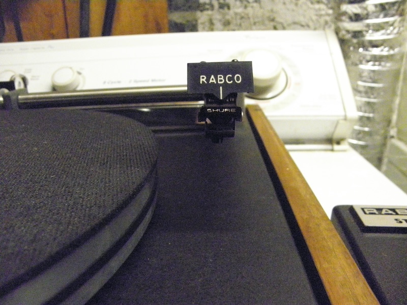

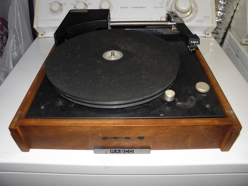

Hello everyone. For several years now, I've had a thing for linear-tracking turntables, as exhibited by my Bang & Olufsen Beogram 8000, its little brother the Beogram TX2, and my Technics SL-10, among several others. I like the ingenuity of the mechanisms which allow them to track parallel with the groove, and the various ways which manufacturers found to do so (both mechanical and electrical, both good and not-so-good).
Ever since I learned of their existence, I wanted something with a Rabco linear arm. Several years ago, I spotted a Rabco ST-4 sitting in the back of a car at one of the MIT Swapfests; the seller was busy, and I figured there was a reason it was there instead of sitting on his table, so I let it pass. More recently, I spotted a Harman-Kardon ST-7 (using a Rabco arm, as H-K bought the company in the early '70s) at one of the Kutztown radio swapmeets, but it was a bit too expensive for my liking ($250), and by the time I finally built up the courage to buy it, it'd been sold. My wallet thanked the buyer, but my heart still wanted a Rabco.
Fast-forward to this past weekend. I managed to get into the MIT Swapfest early, and started looking around the sellers setting up in the parking garage. Near the top of the seller area, I spotted a seller who I recognized from some local audio get-togethers, and who I'd bought stuff from at last month's swapfest. While looking at his wares, including a pair of Pioneer CT-F900s which I eventually bought from him, I spotted a box in the back of his truck labeled "Rabco". Sure enough, it had a ST-4 sitting inside it! I asked him how much he wanted, and he responded with $100. Sold! :mrgreen:
I find this unit rather fascinating. The tonearm it uses is different from the sort used in other Rabco-based turntables; instead of using a separate motor to advance the arm based on microswitches detecting the arm going out-of-true, the arm on the ST-4 rides along a long metal roller which turns along with the platter. The arm has a small idler wheel at the top which is in contact with the roller, keeping the arm true as it rides the groove. The Rabco arm used in the various linear-tracking turntables made by Harman-Kardon have far more in common with the older Rabco SL-8E tonearm (which cost more than the entire ST-4 turntable by itself!) than the arm used in in the ST-4. :?

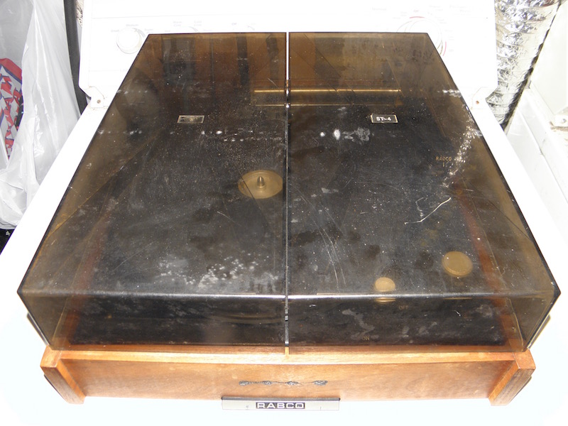

Cosmetically, it's seen better days, but is in pretty good shape overall. One side of the funky split dustcover had bent mounting pins, which I've mostly straightened out. I'm guessing the belts could stand to be replaced, particularly the platter drive one, but they seem to be intact for the most part. When I first powered it up, the platter and tonearm roller slowly started turning. When I pressed the CUE button, the metal flap in front of the arm lowered, slowly dropping the arm onto the junk record I'd placed on the platter, and it started to track. There's supposed to be some sort of end-of-record lift, but it doesn't seem to be working correctly at the moment. I'll have to try and figure out if there's some way to adjust it.
Anyway, enough of my blathering, here are some pictures of the ST-4:
The original box!
What's in the box. Note the split dustcover.
With the dustcover removed.

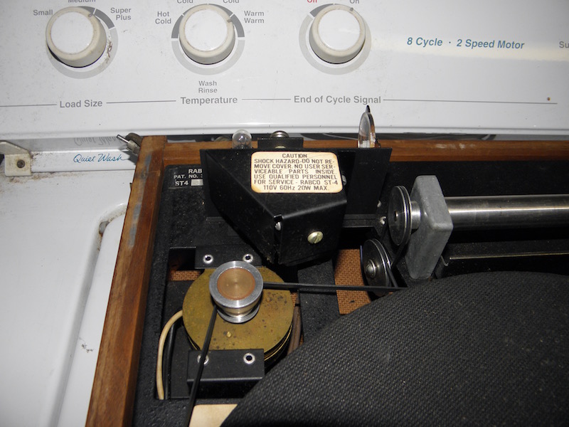

What's under the pulley cover in the top left corner. The instruction manual shows a shift lever of some sort to move the platter belt between the 33 and 45RPM speeds, but there's no sign of it, nor of where it would've been mounted.
The cartridge it came with, a Shure V-15 IV. It happens to be one of my favorite cartridges, which is good because the turntable didn't come with any sort of overhang gauge.
Restoring it should be interesting. There seem to be some issues with the power switch, as the platter doesn't get much (if any) of a 'nudge' when the switch is moved, and the last time I tried to turn it off, it initially refused to power off. Hopefully, it's not something major, but I'm not sure. Any ideas?

I've had my Rabco ST-4 since the early 70's and now have refurbished it for service again.
My only problem is replacing the drive belt. My old belt, that still works, is 36.5" but is spliced and 35+ y/o.
I purchased a FM 34.0 that was supposed to fit, but TOO tight.
I purchased another FRX 35.1 and it too is tight.
According to my CAD layout the belt length should be 37.6".
By tight, I mean the motor spindle will not turn the belt. The spindle seems to bind under the tension and will not move. The drive spindle is odd in that it is two piece. The brass piece is presumably attached to the motor shaft and the outer (silver) spindle is free wheeling. See pic.
Is this some sort of torque limiting coupling?
Can someone check the drive spindle and verify it is two piece?
Anyone have a contact for the proper drive belt? The two services I contacted don't seem to have the answer.
Getting a new 36.5" belt has been difficult.
Is the ST-4 that sensitive to belt tension or is something amiss in my ancient TT?

Mine has the pulley seen in that photo (appropriate, since it's one of the ones I took). I have seen a photo of a ST-4 with a different style of pulley (as seen in a small picture here) which has the larger section on the bottom. I'm not sure exactly how similar the pulley is otherwise. Does your ST-4 have the doohickey which is supposed to shift the belt between pulley sections in order to change speeds?
As far as the belt goes, I've seen pages which recommend either the FM 34.0 or FBL 35.1; have you tried measuring the belt path length using a piece of string? I've heard that modern belts sold by whoever took over PRBline are stiffer than the ones available back in the day. I've seen a picture of an ST-4 on this blog which appears to use an entirely different style of belt. I don't know off-hand what sort it is (gum rubber?), or where they got it. Perhaps you could try sending the blog owner a message asking about it. Good luck!

Adam thanks for the reply.
I don't have the speed doohickey. Mine is just like yours in the picture.
Does the silver spindle stop turning when lightly touched with your finger?
I have video but don't know how to attach it.
If so, then it s is some sort of torque limiting mechanism which tells me the system is sensitive to belt tension and that an exacting belt dimension is critical.
If not, then I have a De-coupled spindle/motor shaft.
The string method measures 37 3/4. 3%-5% (recommend stretch) is 36.62 - 35.86 which tells me my 36.5 length should work if I can find one. I probably will need to talk to these guys, http://www.elexatelier.com/.
