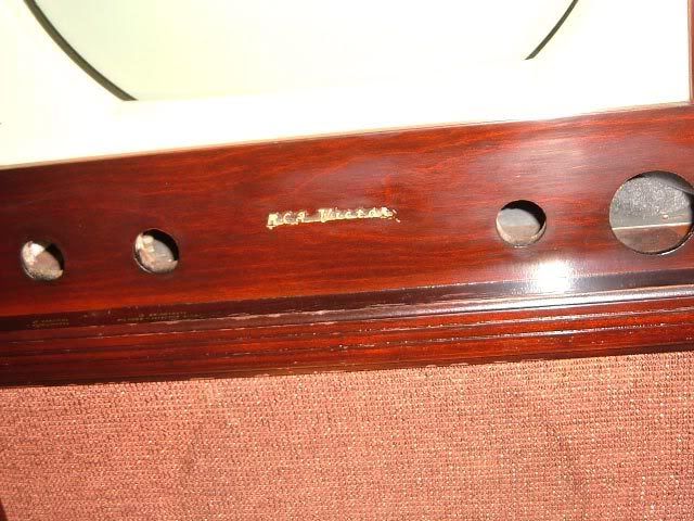

Hi, Guys. At this stage I am working on the cabinet of my latest project.
My RCA Victor 6T74 television. I will be restoring this set back to health.
I recently took delivery from friend Huggy Bear. It came from N Carolina.
See photos.
:? Still having cabinet issues, but, here is the latest. A picture of the restored emblem on my tv. I re-gilded it yesterday.
Bill Cahill :)

That's a nice clean chassis! Did you spend a lot of time cleaning it up, or was this one used a little less than a lot of others?

I must say, and tell the others here...
I picked up this set in Cayce, SC and brought it to Bill on my recent trip to Florida. With all due respect, the set looks a lot better now than when I brought it, Bill is humble in his opinions. It looked OK, but I don't think I would have gone through the trouble myself. The chassis was dirty, and he obviously put some effort into cleaning it, it did NOT look that good when I brought it.
One thing is very obvious - it is a "labor of love" for him on this set. I cannot think of any TV or radio I've had that I would be willing to go to those lengths to restore. To see his expression when I brought it, it was very heartwarming for me. It made my efforts much more worthwhile.
Nice work Bill, and if I know you, you'll have it playing better than new before too long.

Well, I'm still at holding on five more caps, but, hope to get them finnished soon. Then, on to the electrolytics. After that,
it will be time for the "May pop, may go big bang test".
I truly don't know what it is going to do. I am somewhat worried ablut things such as the power transformer, and the yoke. Flyback looks o.k. Never had the vert. output transformer go bad in one of these yet.
I already replaced the incorrect no burned out 47 light bulbs with the correct 51 light bulbs, new, of course.
Speaker looks in excellent shape. Grill closth is really good.
I have a battle plan on the case. I will be merely touching up rough spots on the case, and, dabbing in dark stain on bad spots on doors. No, it won't look mint, but, it will be better. Where finnish is half flaked off, I will first try the dab, and brush new lacquer idea. If that fails, I will reluctantly strip off whole sections of orig. finnsh in those spots, and start all over. But, not on main panels of doors, or case. Only in spots.
Wish me good luck, guys. This is a pho-finnish case, so refinnishing is out of the question.
Another note on electronics of the set.....
I have definately proved that most chassis of this seres used only
their standard series with a 6J5 vertical oscilator, and, very little sync circuit. :? :roll:
However, The "deluxe" sets, including the sets with full doors, including this one, used a 6SN7 instead ot the 6J5. One section was for the vertical osc., and the other was sync amp. The 12AU7 in middle of the chassis was used as sync seperator, and another sync amp. This made this series of sets more stable. In both series, the 12AU7 by back of chassis was video amp. However, in the "deluxe sets, they improved on the quality of the video amp as well. Apparently, it had better contrast than the others.The circuit is definately different.
8)
Thanks, guys.. :)
Bill Cahill :D
